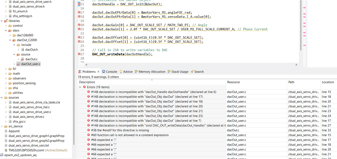

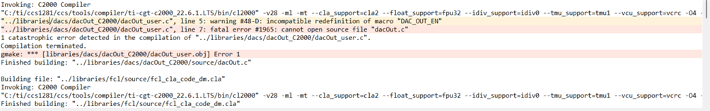

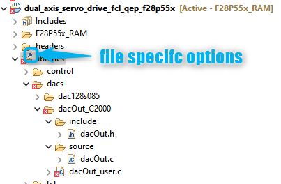

I imported the files "dacOut.c" and "dacOut_user.c" into the project explorer and would like the latter to include the former.
The error you see in the picture appears.

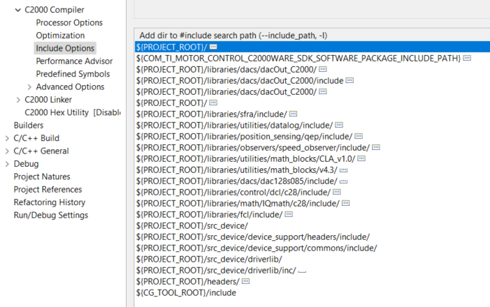

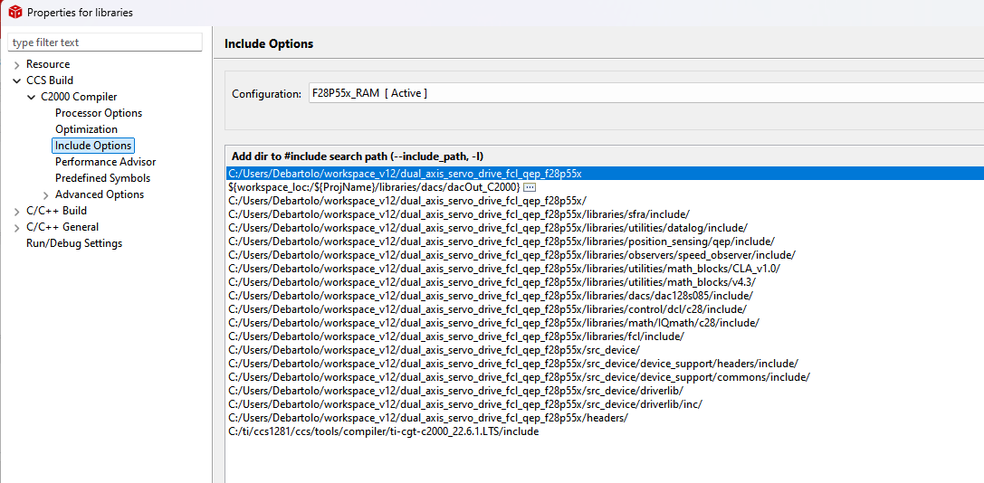

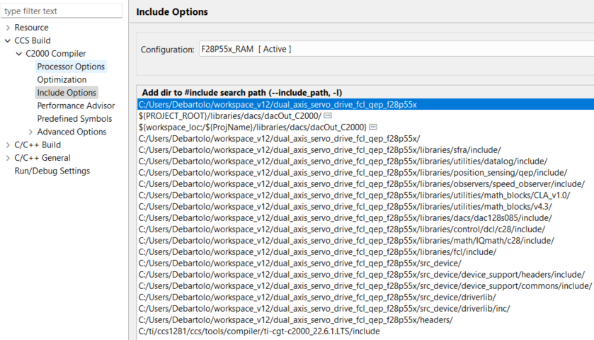

I have tried to include the path where "dacOut.c" is in the include options in the project properties, but I do not solve the problem.
In the console terminal when I build the project, the error is:
I have looked for solutions online but have not figured out how to solve it
