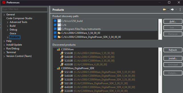

Hello Expert,
I tried building my code on CCS and I am facing the following issue:
Product C2000WARE v5.5.0.00 is not currently installed and no compatible version is available. Please install this product or a compatible version.
Build stopped..
I have C2000WARE v5.05.00.00 and C2000WARE v6_00_00_00 installed. I browsed for the above mentioned version (present in the error) and couldn't find it. Could you please help fix the issue?
Thanks & Regards,
Priyadarshini N M
  • Hi.
    What version of CCS are you using? Please note that starting with CCCS v

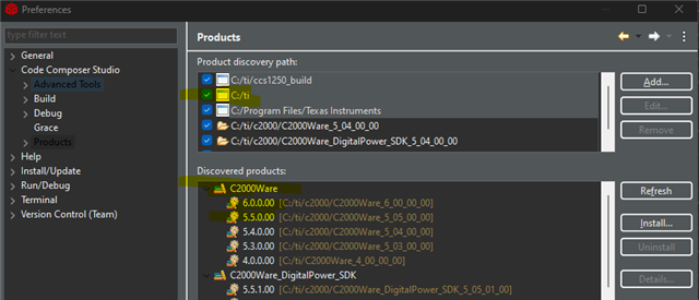

    Can you confirm that the path of your CCS installations is listed under the Product discovery path. Also confirm that they show up under Discovere products. Note: you may need to hit Refresh in order to get the packages discovered by CCS. I had to do that on my setup to get them to appear. Note I am using CCS 12.8.1
    After
    Before
