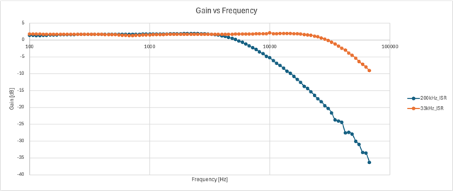

  • The next thing that I ran into that was a bit strange was when I was looking to see the impact of lower ISR execution rate on my D-to-Vo transfer function. I expect the lower my controller execution frequency the faster my phase roll off would be but I am seeing something quite the opposite. Here is a comparison of the plant bode plots with execution at 200kHz and at 33kHz:
For 33kHz the phase roll off seems to occur at a much higher frequency which is very strange to me. Was wondering if someone could help me understand this result.

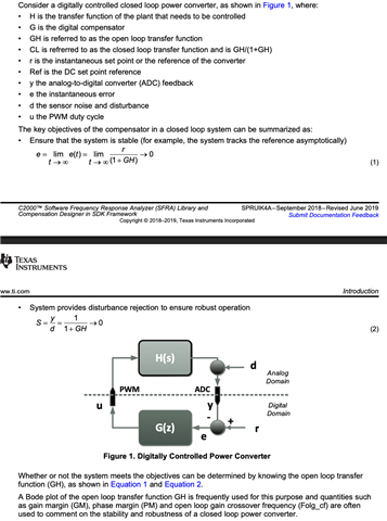

    Thanks for the suggestion. I had skimmed through the documentation for the SFRA library to try to understand what the Plant and Open-Loop models refer to but the strange results for the open loop buck kind of confused me. Specially I looked at this section:
    My understanding for this would be that for an open loop controller buck converter the frequency analysis in the "Plant-model" and the "Open-Loop" model should be the same or the "Open-Loop" frequency response doesn't really make sense to look at since there is no compensator.

  • Hi Munadir,
    There were slight hardware modifications on the board to facilitate better control loop performance, so the actual SFRA plots will differ slightly from the ones shown in the manual.
    Note that roll off is a characteristic that can occur in two directions, depending on the type of filter. For a low-pass filter, the roll-off happens as frequency increases. In a high-pass filter or the lower edge of a band-pass filter, the roll-off occurs as frequency decreases.
    The code features a #define for defining the ISR generation divider. Is that what is being used to generate the lower execution frequency?
    Peter

  • Hi Munadir,
    That makes sense and it looks like your alterations work. Have you tried any other variations in the control frequency apart from 200kHz and 33kHz? Are the changes in the roll-off gradually transitioning between the 2 frequencies just in the opposite direction you are expecting?
    Peter
  • Hi Peter, I have not specifically tried that. Let me give it a try and will keep you posted.
