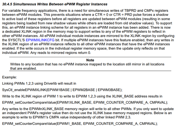

    In the TRM, why is the description of EPWMXLINK missing?
    • There is XLINK within the ePWM registers on F29x, it's now found in the DEV_CFG_REGS in F29x. Please refer to the TRM on how to enable this feature: F29x FAQ
