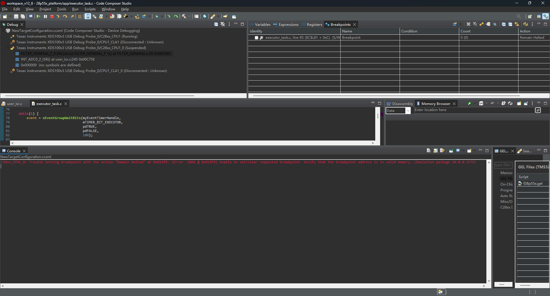

    I have a question about debugging two 28p55, they are connected with only one xds100v3 debug probe in dasiy-chain topology. Now I can download the firmware to the respective flash memory of each DSP. However, I'm having trouble setting breakpoints in the code for the slave DSP. The console is showing an error, and I can't set the breakpoints.  Please help me solve this problem. Following is a screenshot of my ccxml file.

    Yes, I can show you the message. Following the first one is the screenshot of the console and I use the CCS v12.8. You can see I put only one HW breakpoint in the slave DSP but it was wrong. However I found that I can put a breakpoint into the interrupt service routine of the slave DSP but I can not put it in the task.

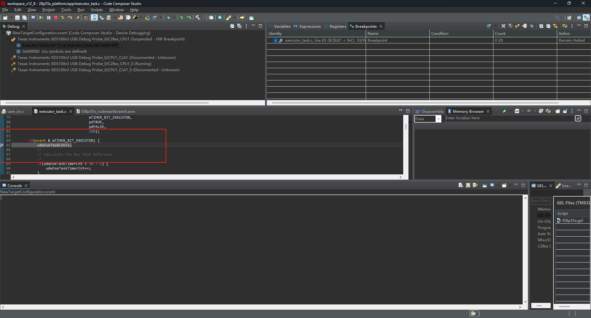

    When I put the same breakpoint into the master DSP, it works successfully. Let me show you in the second screenshoot.
    That is unusual. I have a few clarifying questions:
    1. Are you using any compiler optimizations?
    2. Did you load the symbols for the program on the slave DSP before setting the breakpoint?
    Matt

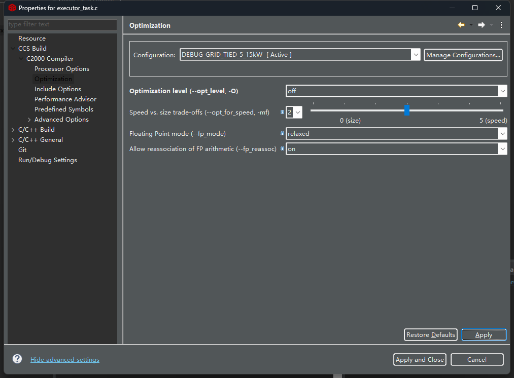

    1. Yes, I am using optimization level-2;
    Can you try turning compiler optimizations off?
    Also, please try removing potential "hidden" breakpoints: https://software-dl.ti.com/ccs/esd/documents/troubleshooting_no-aet-resources.html#resolution

    Sure, Now I have turned off the optimizations and removed all of the breakpoints, but I'm quite sure this still isn't working.

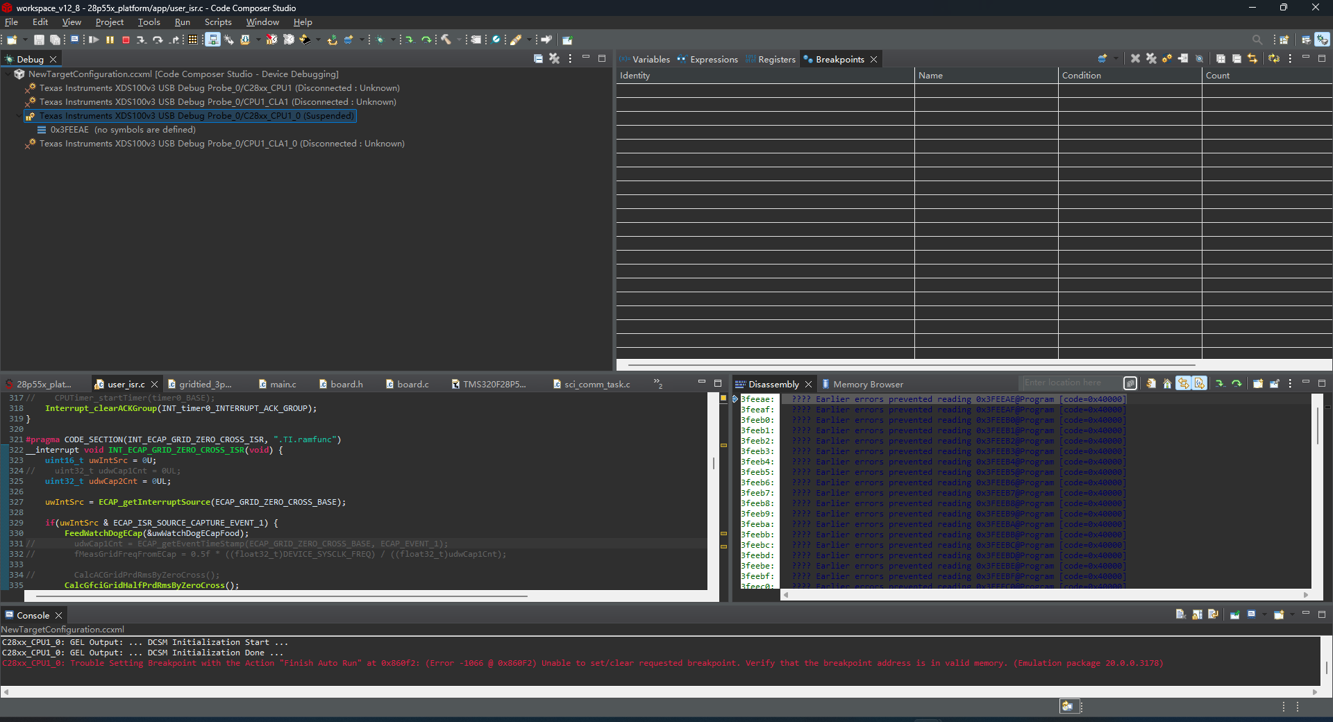

  • There is a known issue with hardware breakpoints on the second device of a dasiy-chained target environment:
    https://sir.ext.ti.com/jira/browse/EXT_EP-10378
    While the information in the link above specifically mentions Tiva devices, it is quite possible it impacts other diasy-chained devices also.
    Is the breakpoint in question a hardware breakpoint? Do software breakpints work?
    ki
    Yes, this happens when they are attempting to set hardware breakpoints (in the flash). Software breakpoints (in the ramfuncs) do not have this issue and work as intended.
