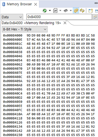

    Below are the first six lines of the hex file.
    The image is a memory browser in CCS.
    Do the hex file and memory match?
    I'm developing a bootloader. I wrote the hex file through the bootloader, and I'm wondering if the data matches.
    :020000040008F2
    :064000009DD90800489D57
    :2040080003BD03BD1C58574C4A5A4C4E575BAD96A407840048464548471F000E101100A946
    :204028008098A61EA9269492AF10AF0E656565656565656565656565656565656565656547
    :204048006565656565656565656565650348034600444241484648AF006F00A98098AF10CD
    :20406800AF0E92A61EA926941F58000A65656565656565656565656565656565656565655D
    Did you align the flash sections in your linker command file on a 64-bit boundary? How are you programming the flash? Please refer to the F2838x Flash API Guide Recommended FSM Flows for the recommended Flash erase and program flows.
    -map=sections.txt --entrypoint=_c_int00 --memwidth=16 --romwidth=8 --order=LS
    What HEX format are you using (TI_TXT, ASCII, INTEL, etc.)?
    Please try using a memwidth and romwidth of 16. Please search the C28x assembly tools manual for the sub-chapter titled Understanding Memory Widths.  That explains the relationship between target width, --memwidth, and --romwidth. On C28x, each address corresponds to one 16-bit word.
    Matt

    and The HEX file is Intel HEX format.
    I'll try changing romwidth to 16.
  • The program is working properly after I set the ROM width to 16. Thanks for your help!
    That's great to hear! I'm glad you were able to resolve it quickly.
    Matt
