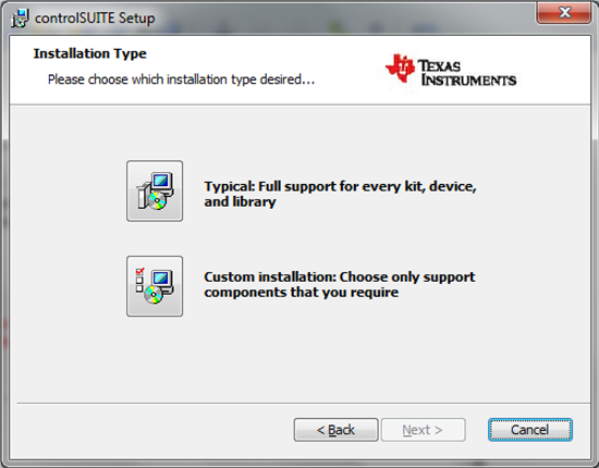

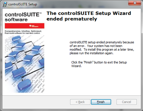

Actually this is my problem that I am not able to install controlSUITE under Windows 7, 32bit. I used three computers (all win7) and none can install controlSUITE. Error "Ended prematurely". I have Linux comp as well I am trying...
So I have problems to get dev. tool in order I am starting a new project and still no success. I am little bit disappointed. :)
Peter,
For windows 7, right click the controlSUITE installer and "Run as Administrator".
Let me know if that works.
Alvaro
or just download the .zip, extract, and run controlsuite.msi
all it does is put the folders onto your HD at c:\ti\controlsuite\
Just did as suggested - no success. "controlSUITE setup ended prematurely because of an error. "
No idea what is going wrong
Peter,
I'm trying to reproduce the error.
At which point in the installer does it crash? What settings did you use for the installation? (Typical, Custom, automatic updates, install path, etc...)
Alvaro
1) I just downloaded controlsuiteinstaller.exe (I have zip as well).
2) Run it as admin
3)
