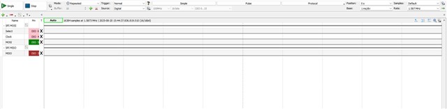

I am unable to generate SPI clock on my launchpadF28379D , I am using SPI B.
In this way I have configured it,

I have attached the evidence below

    I found a mistake and change them, the changes :
    GPIO_setDirectionMode(65, GPIO_DIR_MODE_OUT);    // Direction of CLK_SPIB as Output pin
    GPIO_setDirectionMode(63, GPIO_DIR_MODE_OUT);    // Direction of MOSI_SPIB as Outout pin
  • To be clear, did fixing this mistake fix the problem, or are you still unable to see the SPI clock?
    Jason Osborn
  • Sorry for late reply, No I am unable to see SPI clock.
  • Re-reading what you posted, I've got a few debug steps for you:
    1. Where are you calling SPI_PIN_init_B() and SPI_init_B() ? They're not present in your main() function in the excerpt you posted, and they need to be.
    2. Make sure that your definitions for SPIB_MOSI, SPIB_MISO, SPIB_CLK, and SPIB_SS are correctly set.
    3. MINOR ISSUE: In master mode, STE should also be an output.
    4. MINOR ISSUE: It's generally good practice to explicitly call the GPIO_setMasterCore() function on a device with more than one core, though it's not necessarily required in a single-core project on CPU1.
    Refer to my bolded text for the most impactful issue I noticed.
