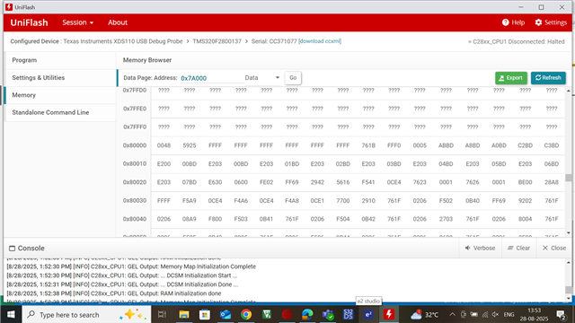

I am using TIDA-010949 development board along with its example code for 600W solar power optimizer.
While using the example code for debugging purpose (generation of PWM waveform for Buck / Boost mode), it works fine.
Controller generates proper PWM output untill the USB power is connected after flashing the code in controller.
But once I disconnected the USB power and re-connects it, controller stops generating any output.
Please advise that what changes are required in program or config file to run the code properly.
