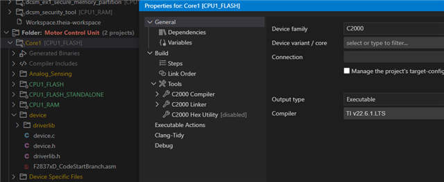

So, we tried exploring GPIO 42 and 43 as Boot pins instead of 72 & 84. We are following the dcsm_security_tool example project imported from Resource Explorer tab in the CCs IDE : c2000 real-time microcontrollers/Embedded Software/C2000Ware(6.00.00.00)/English/Devices/F2837XD/F28377D/Examples/Driverlib/cpu1/dcsm/dcsm_security_tool
We have made below changes in the sysconfig file provided in that project:

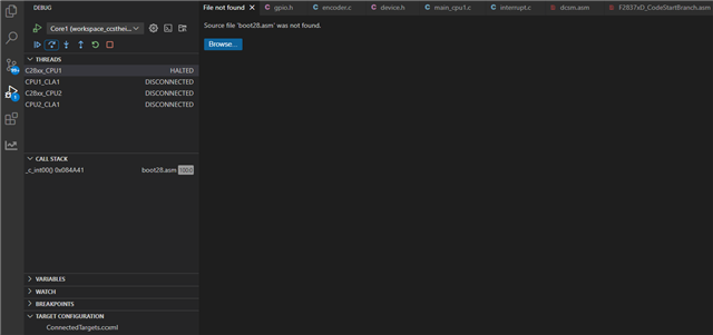

Now, once we test these changes, In debug mode we observe below error after executing the last line : LB _c_int00
Observe below images:
So, wanted to know why is this happening?
Could you help us resolving this ?
Let us know if we are missing anything that also needs to be configured along with the things mentioned in the sysconfig picture above.
FYI: We are using LAUNCHXL-F28379D to test this reconfiguration of Boot pins change first then planning to implement it on our custom board based on the results. The pins 42, 43 aren't pulled up/high with a resistor to 3.3 yet. And we don't see the code reaching main() hitting the set breakpoint inside main().
