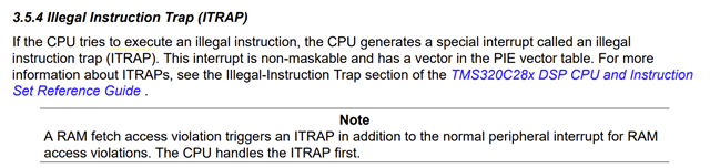

    The example mentions an "access violation." Will this cause the CPU or CLA to generate an exception (fault or trap) that could disrupt normal system operation?

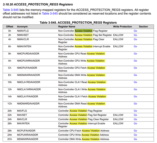

    2) This is in regards to the line of code commented out below it. If the line "cpu1RArray[index] = 1000 + index;" is run, it will throw an access violation since the memory is read only. Access violations result in executing the ITRAP as described in the TRM below.
    There are dedicated ACCESS_PROTECTION_REGS registers for configuration/status of access violations.
