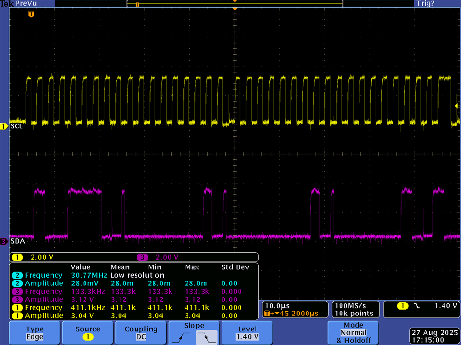

Hello TMS32 team,
Can my main code and sysconfig be checked to make sure I have the right steps?
As I understand, using the I2C library, I need to use I2C_putData() for x many times, where x is the I2C counter value. Then I issue a START condition, I2C_sendStartCondition().
Now, the part I am confused...do I need to insert a manual STOP command or is that automatically sent? I'm unable to communicate successfully with an NI-8452 device when sending more than 1 byte.
Main c file (see the main while loop for few lines of code):

    uint16_t stat = I2C_getStatus(ni_I2C_BASE);
    while(( stat& I2C_STS_BUS_BUSY) == I2C_STS_BUS_BUSY);
    delay_ms(100);
    while(1)
        I2C_putData(ni_I2C_BASE, 0x4);
        I2C_putData(ni_I2C_BASE, 3);
        I2C_putData(ni_I2C_BASE, 5);
        I2C_sendStartCondition(ni_I2C_BASE);
        delay_ms(1);
Sysconfig:

void I2C_init(){
	ni_I2C_init();
void ni_I2C_init(){
	I2C_disableModule(ni_I2C_BASE);
	I2C_initController(ni_I2C_BASE, DEVICE_SYSCLK_FREQ, ni_I2C_BITRATE, I2C_DUTYCYCLE_50);
	I2C_setConfig(ni_I2C_BASE, I2C_CONTROLLER_SEND_MODE);
	I2C_disableLoopback(ni_I2C_BASE);
	I2C_setOwnAddress(ni_I2C_BASE, ni_I2C_OWN_ADDRESS);
	I2C_setTargetAddress(ni_I2C_BASE, ni_I2C_TARGET_ADDRESS);
	I2C_setBitCount(ni_I2C_BASE, I2C_BITCOUNT_8);
	I2C_setDataCount(ni_I2C_BASE, 3);
	I2C_setAddressMode(ni_I2C_BASE, I2C_ADDR_MODE_7BITS);
	I2C_disableFIFO(ni_I2C_BASE);
	I2C_setEmulationMode(ni_I2C_BASE, I2C_EMULATION_FREE_RUN);
	I2C_enableModule(ni_I2C_BASE);

Edit [8/27]: I wanted to add that I can receive data but the bytes received are not correct. For example, if I set the counter to 3 and send 3 bytes [0x1, 0x2, 0x3] then I receive them out of order. This is what I read from the NI I2C slave/peripheral device after 10 sets of 3-byte data are sent. I tried sending a stop command right after sending the start command. Still have same issue.
['0x1', '0x3', '0x3']
['0x0', '0x0', '0x0']
['0x3', '0x3', '0x3']
['0x3', '0x2', '0x1']
['0x1', '0x1', '0x3']
Example scope shot:

  • Hi Aishwarya,
    Per scope shot I sent previously, you can see that the data is not properly sent as 0x1, 0x2, 0x3.
    I did reference the examples but did not follow it line-by-line as they use interrupts in all of the examples and I am not.
    Can you please clarify what you mean by "Can you confirm the transmit side is correct via registers? " How do I do that?
    Thank you,
    Jennifer

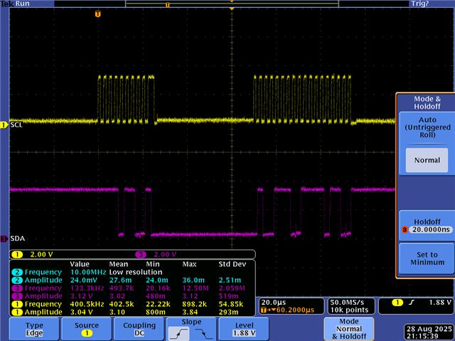

    Scopeshot of two bytes sent in one transaction (expected):
    However, when I set up for 3 byte send by adding one more "putData" and setting the data count =3 in SYSCONFIG,the data is not sent or received as expected. Only the first and last bytes are sent and received. I sent 0xA, 0xB, 0xC.

    Data sent with delay between bytes (unlike with the two byte send):
    Any thoughts or suggestions on what I could be doing wrong?

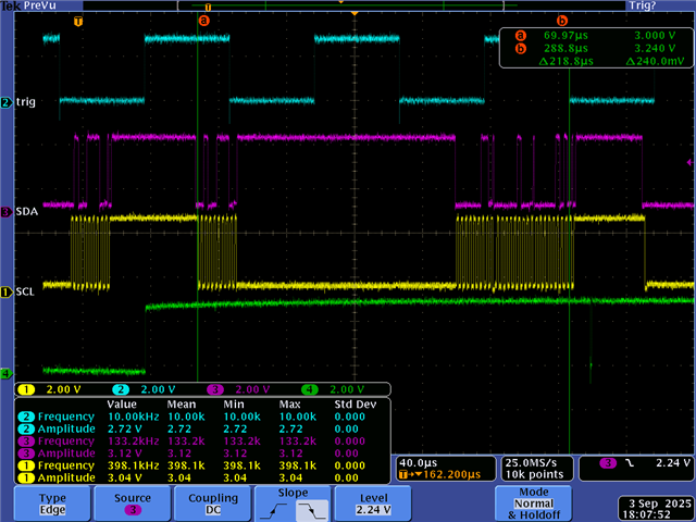

  • Hi Aishwarya ,
    Yes, I have tried to use 100k and 400kHz rates. Same issue.
    I did find the ex polling code and that resolves my issue with not getting the 3 bytes send accurately. However, another issue comes up:
    By leveraging the "i2c_ex4_eeprom_polling", I see there is a large delay (about 125 us) between the ACK bit and the first DATA bit. Is this expected? Anyway to improve? This is detrimental to my use case where I must send 3 bytes every ~10 kHz.
    Thank you,
    Jennifer
  • Jennifer,
    Besides using the polling example, did you do anything else differently? Glad to hear it works.
    C2000 I2C only requires about 9 us for setup + bus free time from STOP to START condition. There is some minimum setup time required by the target device, as mentioned here as well. I also see this note but not sure if it applies here:  . From a C2000 perspective, you can try removing any delays if you have any.
    Aishwarya

  • Jennifer,
    Apologies for the delay as I was out of office last week. I do expect bus delays, but I unfortunately don't have a setup to test tens of thousands of devices as well with the exact target device being used here. As mentioned earlier, as long as the minimum timing requirements are met (which is significantly below the 125 us), there is no issue with this delay.
    It is common for delays to happen when the I2C target is holding the clock line. You can try testing with a different target or even without a target to observe this behavior. Feel free to also modify the FMOD and related configurations, though, I suspect the delay will remain.
    Aishwarya
