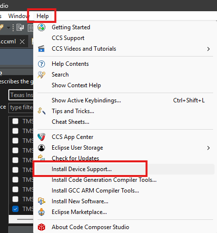

    If I can still keep the CCS12.7.0, to add C2000 deice support, I check the link you provided. So I can run the CCS installer again and add support for C2000 device families. Is that correct? Or could you provide the update site of the C2000 so that I can do CCS -> Help -> Install New Software...

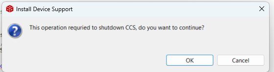

    Thanks for your screenshot of the Install Device Support. I tried that, however I got a message as below. Once I click the Ok, CCS closed but nothing else happened. Any further instruction for it?
    That can also work. You can also uninstall current CCS12.7, then reinstall and make sure you have C2000 device support enabled when installing again.
    Apologize for this. May be best to just reinstall CCS12.7 if you want to use this version.
