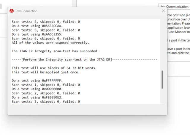

Working with TMDSCNCD280039C. Everything was working 1 month ago, Come back this project found that the program can not be loaded with Error-1015
Test connection in target configuration with no failure. And blue LED2:A is blinking during the test. LED3:A is always on when powered up.

  • I do have one baseboard, but I dont have any external debug probe. any other way I can try? Do that "test connection" results tell anything?
    That is true, test connection verifies that the JTAG signals are connected correctly.

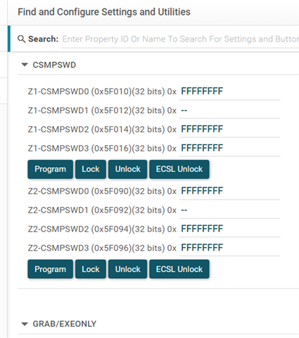

    Can you try putting the device in wait boot and try unlocking the device with the default passwords in UniFlash or CCS? If your project does not contain any passwords and you are unable to connect to the device now, I wonder if your device got locked accidentally.
    Matt
  • Can you be more specific on how to get put it in "wait boot" mode and how to unlock with the default password?
    I tried UniFlash. it recognizes the TDS110 and the board. Then when I click Erase Flash, same error -1105 Error, as posted in the original post.
    Any other ways I can try?
    Please set S2 to wait boot, following this table (position 1: up, position2: down). Wait boot mode puts the device in a known state in the boot ROM and is the most compatible for JTAG connectivity.
    In UniFlash, go to "Settings & Utilities" and scroll down to "Security Settings". Click on "Fill Security Fields from Target".
    Scroll down to "JTAGLOCK". What value is loaded here?
    Scroll down a bit more to "CSMPSWD". What are the values?
    Then, select "Unlock". Does the operation succeed? If so, can you connect to the device now?
    Matt
  • same error after "Fill Security Fields from Target"
    Same error if I try to click "Lock" or "Unlock"
