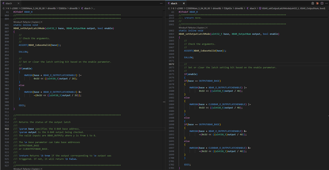

I am migrating the BISS-C interface form F28P65 to F280039,
I am using the C2000 IDEA the run migration check throughout the lib project, any the only problem is shows is that F280039C is missing:
  • CLB output latch feature
  • SPID
Any suggestion how to address these problems? (If changing from SPID to SPIA, what's the change required and if C2000 IDEA can help making the change?)

  • Hi Hang,
    Could you please provide screenshots on what exactly you are seeing and what is missing that you would have maybe expected for both those checks? The migration checks in place are typically at the peripheral feature level, not necessarily for changing peripheral instances as this is very application specific.
    Aishwarya

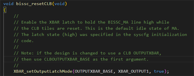

  • Hi Hang,
    Are you evaluating BISS-C with LAUNCHXL-F280039C + BOOSTXL-POSMGR? You will need to use SPIB since the boosterpack is designed to fit on site 2 of the LaunchPad (bottom 40-pin header). See the pinout for this LaunchPad here: https://www.ti.com/lit/ml/spruj30/spruj30.pdf

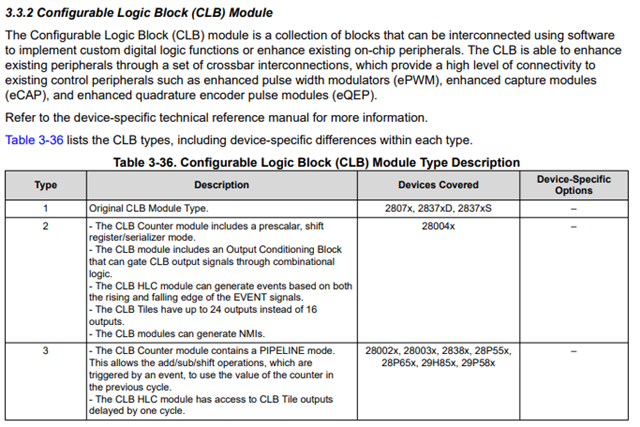

    F28P65x and F280039C have the same CLB module peripheral so there will not need to be any adjustments to the CLB logic
