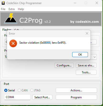

TMS320F2800132: When Program by SCI bootlodder getting Sector violation error
Part Number: TMS320F2800132
Other Parts Discussed in Thread: TMS320F2800137, C2000WARE
Dear Sir
      I have taken the example program of Launch pad TMS320F2800137  & changed its target to TMS320F2800132  & build it and then SCI bootloading by C2prog application  But i a getting Sector violation error
Please help
With Regards
Yusuf
  • I am using CCS 12.8.0  as per above when i am using  F2800132_flash_lnk.cmd    file while building it shows memory gap error    the memory adress of the flash banks are  not proper align to its length & origin. so  i change  orgin memory adress as per the length define ( attached the changed file )    the projects gets build and .out file is generated . When i try to load the .out file by SCI bootloader using C2Prog   application ,it show sector violation  .   I think in this linker file there is some error in memory alloctaion .
    Please fi you can guide or can send me flash linker file

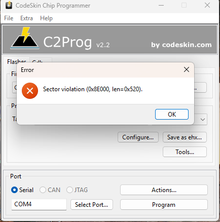

  • Hi Yusuf,
    0x8E000 address location refers to Flash Bank 0 Sectors 56-63. The F2800132 device only has 64KB of available flash memory for programming, so flash programming is not available beyond Sector 31 range per Flash Memory Map in device datasheet.
    Can you refer to the 280013x_generic_flash_lnk.cmd file as a reference? It's located here:
    C:\ti\C2000Ware_6_00_00_00\device_support\f280013x\common\cmd\280013x_generic_flash_lnk.cmd
    The cause of error likely we are trying to program non-available memory space.
    Thanks and regards,
    Charles
  • Hi Charles  As per your suggestion i tried with 280013x_generic  linker   file but still it shows error as below
       Early i was using  the F2800132_flash_lnk.cmd   from CCS 12.08 folder i am attaching the linker file , and begin adress is 0x80000  and its end adress is 0x8FFFF   ,which is 64k only   below is cmd file for refrence

             please suggest is there in problem with linker file , Pls help to solve the problem
  • Hi Yusuf,
    The issue is that the linker file uses more than SECTOR 0-31 for flash programming (the .text assigned sectors in the 64KB covers a larger range).
    I had suggested the default file to compare how they set the sector length.
    The solution would be something as follows:

    GROUP {      /* GROUP memory ranges for crc/checksum of entire flash */
       #endif
    #endif
      BEGIN            : origin = 0x00080000, length = 0x00000002
       /* Flash sectors */
       /* BANK 0 */
         /* Flash sectors */
       FLASH_BANK0_SEC_0_7     : origin = 0x080002, length = 0x1FFE  /* on-chip Flash */
       FLASH_BANK0_SEC_8_15    : origin = 0x082000, length = 0x2000  /* on-chip Flash */
       FLASH_BANK0_SEC_16_23   : origin = 0x084000, length = 0x2000  /* on-chip Flash */
       FLASH_BANK0_SEC_24      : origin = 0x086000, length = 0x0400  /* on-chip Flash */
       FLASH_BANK0_SEC_25      : origin = 0x086400, length = 0x0400  /* on-chip Flash */
       FLASH_BANK0_SEC_26      : origin = 0x086800, length = 0x0400  /* on-chip Flash */
       FLASH_BANK0_SEC_27      : origin = 0x086C00, length = 0x0400  /* on-chip Flash */
       FLASH_BANK0_SEC_28      : origin = 0x087000, length = 0x0400  /* on-chip Flash */
       FLASH_BANK0_SEC_29      : origin = 0x087400, length = 0x0400  /* on-chip Flash */
       FLASH_BANK0_SEC_30      : origin = 0x087800, length = 0x0400  /* on-chip Flash */
       FLASH_BANK0_SEC_31      : origin = 0x087C00, length = 0x0400  /* on-chip Flash */
       //FLASH_BANK0_SEC_32      : origin = 0x088000, length = 0x0400  /* on-chip Flash */
       //FLASH_BANK0_SEC_33      : origin = 0x088400, length = 0x0400  /* on-chip Flash */
       //FLASH_BANK0_SEC_34      : origin = 0x088800, length = 0x0400  /* on-chip Flash */
       //FLASH_BANK0_SEC_35      : origin = 0x088C00, length = 0x0400  /* on-chip Flash */
       //FLASH_BANK0_SEC_36      : origin = 0x089000, length = 0x0400  /* on-chip Flash */
       //FLASH_BANK0_SEC_37      : origin = 0x089400, length = 0x0400  /* on-chip Flash */
       //FLASH_BANK0_SEC_38      : origin = 0x089800, length = 0x0400  /* on-chip Flash */
       //FLASH_BANK0_SEC_39      : origin = 0x089C00, length = 0x0400  /* on-chip Flash */
       //FLASH_BANK0_SEC_40_47   : origin = 0x08A000, length = 0x2000  /* on-chip Flash */
       //FLASH_BANK0_SEC_48_55   : origin = 0x08C000, length = 0x2000  /* on-chip Flash */
       //FLASH_BANK0_SEC_56_63   : origin = 0x08E000, length = 0x1FF0  /* on-chip Flash */
       //FLASH_BANK0_SEC_63_DO_NOT_USE : origin = 0x08FFF0, length = 0x0010  /* Reserve and do not use for code as per the errata advisory "Memory: Prefetching Beyond Valid Memory" */
    #ifdef __TI_COMPILER_VERSION__
      #if __TI_COMPILER_VERSION__ >= 20012000
    }  crc(_ccs_flash_checksum, algorithm=C28_CHECKSUM_16)
      #endif
    #endif
    SECTIONS
       codestart        : > BEGIN
       .text            : >> FLASH_BANK0_SEC_8_15    | FLASH_BANK0_SEC_16_23   | FLASH_BANK0_SEC_24    |
                             FLASH_BANK0_SEC_25      | FLASH_BANK0_SEC_26      | FLASH_BANK0_SEC_27    |
                             FLASH_BANK0_SEC_28      | FLASH_BANK0_SEC_29      | FLASH_BANK0_SEC_30    |
                             FLASH_BANK0_SEC_31 , ALIGN(8)
       .cinit           : > FLASH_BANK0_SEC_31, ALIGN(8)
       .switch          : > FLASH_BANK0_SEC_31, ALIGN(8)
       .reset           : > RESET,  TYPE = DSECT /* not used, */
       .stack           : > RAMM1
    #if defined(__TI_EABI__)
       .bss             : > RAMLS0
       .bss:output      : > RAMLS0
       .init_array      : >> FLASH_BANK0_SEC_31, ALIGN(8)
       .const           : >> FLASH_BANK0_SEC_31, ALIGN(8)
       .data            : > RAMLS0
       .sysmem          : > RAMLS0
      .bss:cio          : > RAMLS0
    #else
       .pinit           : >> FLASH_BANK0_SEC_31, ALIGN(8)
       .ebss            : > RAMLS0
       .econst          : >> FLASH_BANK0_SEC_31, ALIGN(8)
       .esysmem         : > RAMLS0
       .cio             : > RAMLS0
    #endif
       .TI.ramfunc      : LOAD = FLASH_BANK0_SEC_8_15,
                          RUN = RAMLS0,
                          LOAD_START(RamfuncsLoadStart),
                          LOAD_SIZE(RamfuncsLoadSize),
                          LOAD_END(RamfuncsLoadEnd),
                          RUN_START(RamfuncsRunStart),
                          RUN_SIZE(RamfuncsRunSize),
                          RUN_END(RamfuncsRunEnd),
                          ALIGN(8)
    #else
                          RUN = RAMLS0,
                          LOAD_START(_RamfuncsLoadStart),
                          LOAD_SIZE(_RamfuncsLoadSize),
                          LOAD_END(_RamfuncsLoadEnd),
                          RUN_START(_RamfuncsRunStart),
                          RUN_SIZE(_RamfuncsRunSize),
                          RUN_END(_RamfuncsRunEnd),
                          ALIGN(8)
    #endif
        /*  Allocate IQ math areas: */
       IQmath           : > RAMLS1
       IQmathTables     : > RAMLS1
       /* crc/checksum section configured as COPY section to avoid including in executable */
       .TI.memcrc          : type = COPY
    // End of file.
    Thanks and regards,
    Charles
  • Thanks charles   issue is solved    there was problem in linker file of generic  the const and cinit was try to load on sector 32_39 which is not available in F2800132  I changed the linker file as below and it worked
