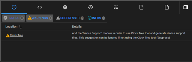

Plz let me know how to add "Device Support" module to remove warning in the following.

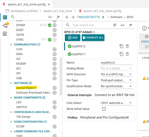

Pls refer the snapshot below, this is the view when you open the Sysconfig file.
You can see "Device Support" option on the left pane. You can add it from here.
