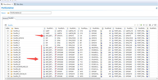

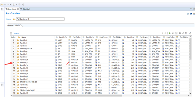

This is the initial configuration of my PORT module.
I referred to the GPIO241 pin in the DIO module.In order to obtain the correct DioChanelID, I executed the RUN function, which automatically calculated the correct Dio ID.
But my PORT configuration is all wrong. It has turned out like this. Why is that?
  • This should be caused by the fact that I used the PORT.xdm configuration file of F29H85xMCAL-01.02.01 to overwrite the PORT.xdm of F29H85xMCAL-01.03.00.In the new F29H85xMCAL-01.03.00, the xdm file of the old version MCAL is referenced.
