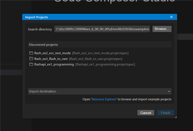

  • I have CCS 20.2.0. I created my folder on local. Added that to the workspace.
    Then I went to file-> Import Project. Browse
    Is this the correct path 'C:\ti\c2000\C2000Ware_6_00_00_00\driverlib\f2838x\examples\c28x\flash\CCS'?
    When I select this path, I see three projects loaded. Do I need to choose only flashapi_ex1_programming?
  • Hi Vigita,
    Yes, you can just select the flashapi_ex1_programming example and import that project into the workspace.
    Thanks and regards,
    Charles
  • okay. Done. What will be the next step?

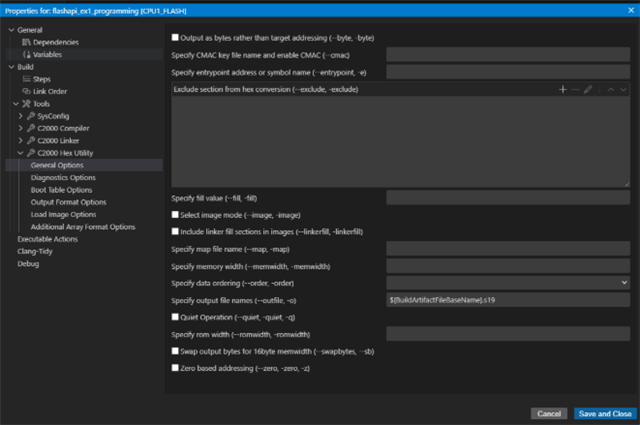

  • Next step would be to configure the generated output for this project. This can be done by going to:
    1. Right-click the project in CCS and go to the Properties tab.
    2. Enable the C2000 Hex Utility.
    3. Go to the C2000 Hex Utility Output Format Options and select the Motorola S hex option to generate the .s19 record output file.
    The algorithm that requires this .s19 format is within the BPM Programmer software?
    Charles
  • OKay. So here is what I did.
    I imported the flashapi_ex1_programming
    I selected the motorola m3 format
    I did not change anything in the files
    Then I did a build.
    I didnt see any .s19 generated.
    Then I updated the ‘specify output file name’
    I did a build again. I see a .s19 file in device folder
    This is what I understand now.
    I set the gpio72 and gpio84 to low..parallel boot mode
    Then using gpio 89 90 58 59 60 61 62 88, I send the bootcode to the device. I will be using gpio 91 and 92 as communication signals between my programmer and the device.
    Please let me know if my understanding is correct. Thanks!
    What will be the next step after that.
    How do I make this code to erase or program, or read my flash? What commands should I send, and which pins should I use to send and receive to and from flash?
