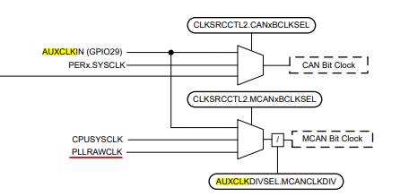

    Yes, a bit tricky to get 80MHz MCAN clk from SYSCLK.  You drop SYSCLK to 80MHz and use a div by 1 for MCAN but that means other modules and CPU will be executing at slower clock of 80MHz.  One option that I have not tried, but would probably work is to source MCAN CLK from PLLRAW CLK.  In the clocking diagram of F28003x below, PLLRAW clock is the output clock of the PLL:
    Diving PLLRAWCLK with SYSCLK divider will produce SYSCLK.  So if PLLRAWCLK is configured to 240MHz and PLLSYSCLKDIV = 1 (divide by 2), the SYSCLK is 120MHz.  In the MCAN block, the MCAN Bit Clock can be derived from AUXCL (60MHz max) or SYSCLK (120MHz max) or PLLRAW Clock (240Mhz max).  You can then choose MCAN bit clock to be sourced from PLLRAWCLK (from register CLKSCRCTL2.MCANxBCLKSE) and set the MCAN clock divider to 3 to produce the 80MHz MCAN clock.  You'll have more granularity with tq with 80MHz MCAN CLK.
