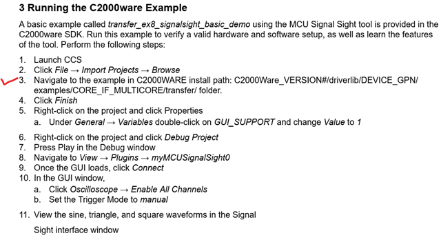

1) I have started reading the document provided for MCU signal sight tool. In the section 2.1 (of the MCU signal sight tool pdf), it is said that we can download the stand alone version as well, but i am unable to find a standalone version with name MCU signal sight tool. where to find the standalone version?
2) It is told in the document (pic below), to find an example in C2000Ware but i don't find anything with the name transfer in f28379D (I am using C2000WARE 6_00_00_00).
3) While I run the program in LaunchXL in debug mode I don't see any option of View -> plugins (of course I am running my own custom ADC program in RAM).
4) I am not sure of how to get started to use MUC signal sight tool. Could you please direct me on how to start using MCU signal sight tool.
Thank you
Vijay
  • Hi Vijay,
    Our SDK automation doesn't support F28379D devices. Theoretically the signal sight example should work for F28379D as it only uses CPU + SCI peripheral, but we don't have the example available in the SDK. It will need to be ported from another device, such as F2838x or F28004x.
    We are still working on setting up the product page for this tool, so that will be available shortly and you may download the standalone tool from there.
    Peter
