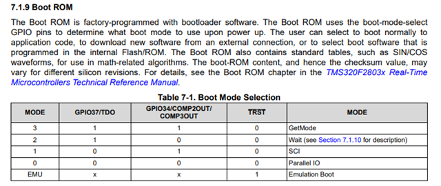

  • I would try Wait Boot mode, this will keep the device outside of the CSM protected region, so that JTAG connection will be allowed:
    You can then inspect the CSM password locations to see if the device is locked(a simple read of those locations should unlock the device, and you will see all 0xFFFF).

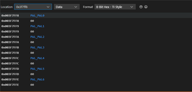

  • When I try to "Connect Target", the device always enters HALTED state.
    I attempted to erase or unlock the device from the CCS Properties menu, but it only shows unknown error.
    In the password location, I see 00written.
    Does this mean the device has been locked?
    I was able to connect via JTAG in Wait Boot mode, but I would like to know if there is a way to completely erase or reset the Flash by switching to some kind of emulation boot mode or another method.

  • Since you are seeing all 0x0000 in the password locations, this means that the device has a password programmed to it and is locked.  As you mentioned in your original post, if the flash operation was interrupted previously it can result in a non 0xFFFF value in the CSM password locations, which will (and likely has) locked the device.
    Since the CSM password is un-known, there is no way to recover the device, or get it back to a default state.  The only solution/path forward will be to replace the MCU.
