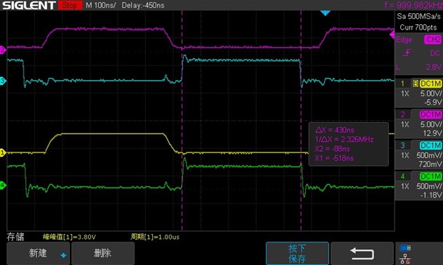

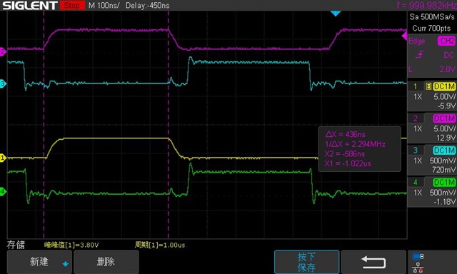

  • Now I am study the LAUNCHXL F28P55X HRPWM function, I am try to create the LLC full bridge HRPWM drive, but I meet a issue that E1PWM OUTA TON not equal to OUTB ton, but E2PWM OUTA TON is equal to OUTB ton.
    Below is the details info, could you please help to provide some suggestions.
    LLC frequency = 1MHZ.
    TBCLK = 150MHZ
    Use up-down counter mode.
    So the period = 75.
    HRPWM with SFO().
    AC configure like below, so only compare A impact the duty:
    EXPWMA and EXPWMB output is complementary:
    Both Period and compare A are implemented high resolution, I can use CMPAHR for duty control.
    As above, when the period is 0x4B, COMPA is 0x00257F,  CMPA is 50% of the period, as the FED delay and RED delay are the same, so the ton time of OUTA and OUT B should be the same.
    But unfortunately, OUTA ton time is greater than OUTB ton time, could you please provide me some suggestions.
    However i also configure EPWM2 same as EPWM1, from EPWM2, the OUTA ton time is equal to OUTB ton time, it is very strange.
    Below is the waveform of my test results:

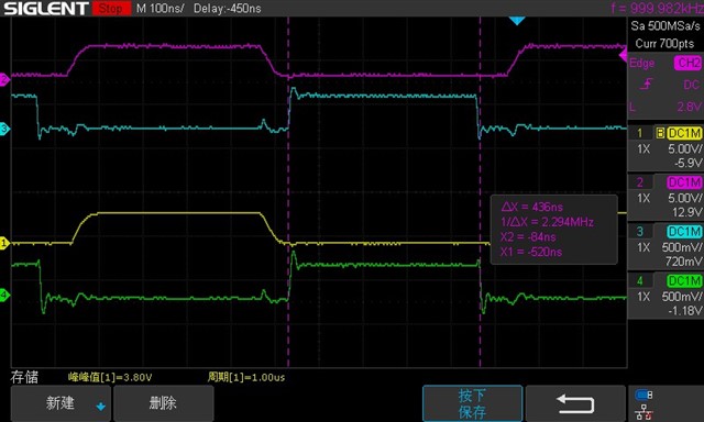

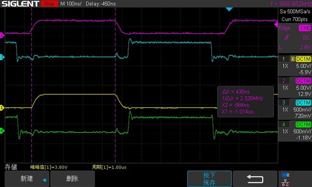

    Purple: EPWM1 OUTA, Blue:EPWM1 OUTB,
    OUT A ton = 436ns, OUTB TON= 430ns, this is not measurement error, I have double check many times.
    Yellow: EPWM2 OUTA, Green:EPWM2 OUTB,
    OUT A ton = 436ns, OUTB TON= 436ns, this is the expect result,

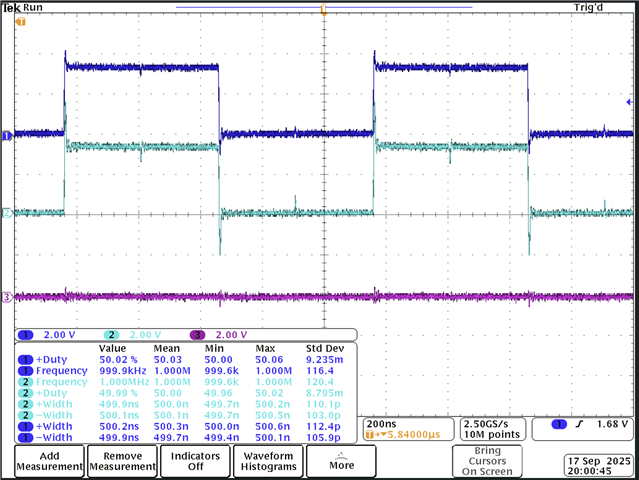

  • I used your sysconfig to recreate the issue. When you load TBPRD= 75 in sysconfig, did you change the following highlighted as well considering this used in duty and HRPWM factor calculations. Value is 76 because of the up counter mode formula? When I changed that, it fixed the issue as shown in scope shot below. Could you please try this and let me know if this resolved your issue?
    Sumit
  • when you change the period to 76, the CMPAHR will change to 0, so the issue will disapear, if you change the period to 75 or 77 then the CMPAHR will non-zero, then the issue will repeat.
  • Could you please elaborate your question? Like under what condition you are getting asymmetric duty? Also when you change TBPRD are you also changing corresponding duty HR factor?
