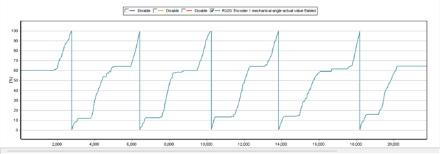

  • Hi Lori,
    You're right. It's exactly this situation.
    I tried to filter out the CRC errors, manually rotated the 31-bit resolution Endat encoder for five turns, and used our upper computer tool to check the position changes and the number of turns calculated by the program during the rotation process. They matched up, indicating that the DSP program has no problem extracting the raw data.
    At present, I have only used the EEPROM-related commands and the ENCODER_SEND_POSITION_VALUES command. Below are several sets of data I randomly grabbed. I hope they can be of help.And please forgive me for forgetting to capture the data returned by the original encoder.
