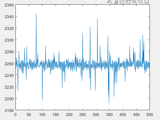

I need to perform fault diagnosis on the motor now and require a highly accurate current value. The zero position voltage measured by the current sensor is very stable, but after entering the ADC module of the f28379d, the measured current error is very large. The measured current has an error of about ±1A, that is, there is an error of 30/4096 during ADC sampling, which cannot meet the requirements of my fault diagnosis. May I ask if this is a problem with the chip or the development board?

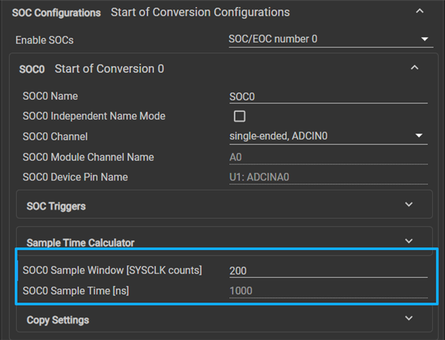

    2. Increase the ACQPS; this is the sample/hold time to charge the ADC internal sampling capacitor.  If there is some impedance mis-match on the signal fed into the ADC it will result in the cap not accurately capturing the voltage on the pin.  Try to increase this value(maybe by an order of 10) to see if you get better error on your voltage conversion

  • Hello, I tried it as per your suggestion. I tested it with the ADC tutorial of TI. The specific tutorial link is here. dev.ti.com/.../c2000_lab_adc.html
    The test results are the same as before. There is still a significant fluctuation.The specific effect is as shown in Figure 1.
    In addition, I conducted a test using a No. 7 dry battery, and the outcome was the same. The digital signal values obtained still fluctuated.
    Also, regarding the ACQPS you mentioned, is it the Sample Window [SYSCLK counts] in syscfg, as shown in Figure 2? I changed it from 20 to 200, but there was no change.

  • Can you try 2 things:
    1)With the code as-is from lab, increase the ADC clock divider from 4 to 8 and see if there is any improvement
    2)Remove the LED toggle from this code and see if there is any improvement.
    Also, could  you probe the output of the amplifiers, that supply VREFHI to the device, and let me know what voltage you read?
    Matthew

    1) I'm not sure which pin in Figure 1or2 can measure the supply VREFHI you mentioned. Could you please let me know?
    2) I conducted the experiment as per your suggestion, setting the clock divider to 8 and turning off the operation of other unnecessary GPIO. However, the result is as shown in Figure 3, and there has been no improvement.
