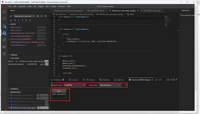

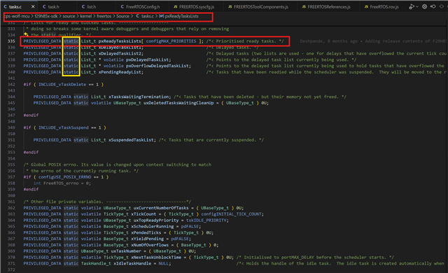

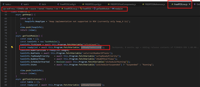

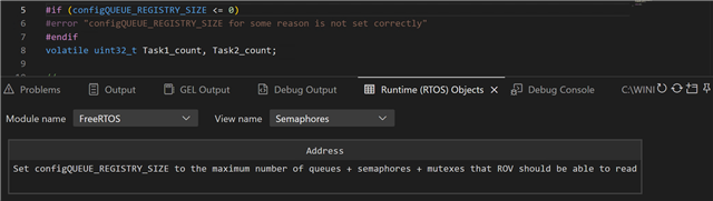

I am currently trying to enable the ROV for debugging purposes, However I get a problem that the debug variables that should be displayed in a human readable format in the "Runtime RTOS objects" view in CCS are private.
The debug variables are within the kernel's freertos sources.
This is shown in the following screenshots:
That prevents the "FreeRTOS.rov.js" script from accessing the variables and displaying them in the view as shown below:
How can I fix the problem?

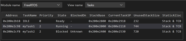

  • Hi Mahmoud,

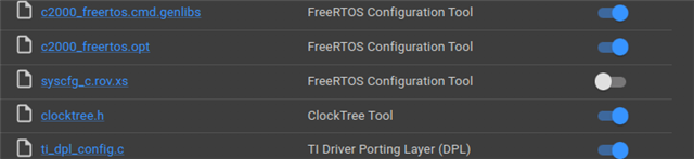

    This needs a minor compatibility update. Please follow the below steps.
    1) In SysConfig, exclude the generated syscfg_c.rov.xs from build
    2) Paste the following syscfg_c.rov.xs anywhere in your project directory (the file name should match exactly).
    https://e2e.ti.com/cfs-file/__key/communityserver-discussions-components-files/171/syscfg_5F00_c.rov.xs
    After these changes, you should see the ROV reflect the full view. Let me know if you face any other issues.
    Arnav

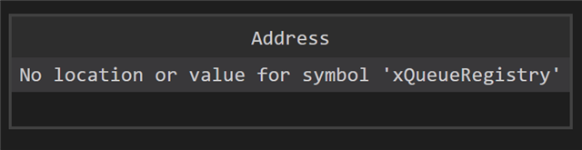

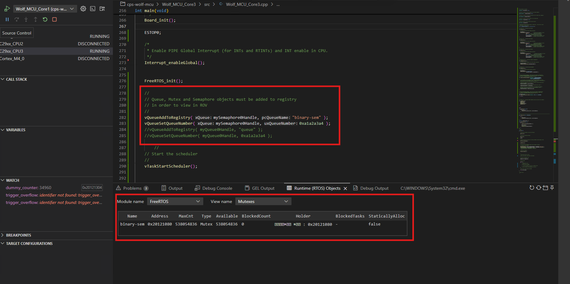

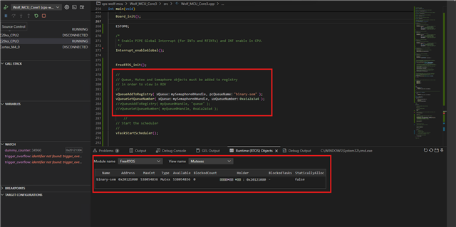

  • Hi Menon
    Thanks for the tip! I followed your instructions and managed to get the tasks view working:
    However with queues, semaphores, and mutexes, I keep getting an error message that configQUEUE_REGISTRY_SIZE is set to zero, even though I added a compile time check for its value being positive here, and the code compiles:
    Is there another potential compatibility issue here?
  • Hi Mahmoud,
    Yes, there is a compatibility update required in the ROV file (This has to do with the configUSE_MINI_LIST_ITEM being set to 0 in the SDK). You can replace the file at f29h85x-sdk/source/kernel/freertos/rov/ with the following and see if you still face any issue. Thanks for pointing this out, it will be fixed in the next release

    I have however not been able to replicate your error with the configQUEUE_REGISTRY_SIZE. Can you make the above change, and try placing breakpoints inside some tasks to see if there's any change in the ROV tables?
    Arnav
    Thanks for the help. I tried replacing FreeRTOS.rov.js in the SDK with the one you shared, but unfortunately the issue still persists. I then did some modifications so that the exception thrown related to configQUEUE_REGISTRY_SIZE is displayed as the error message. This was the output:
    This should be the exception message thrown by js itself. For some reason it's not detecting xQueueRegistry, even though I set configQUEUE_REGISTRY_SIZE correctly.
    Another thing I noticed when trying to modify configUSE_MINI_LIST_ITEM  using Syscfg is this error:
    Does this mean that for C29s configUSE_MINI_LIST_ITEM has to be zero ?
    Mahmoud
  • Have you registered all required elements to the FreeRTOS registry in your application? This is not done by SysConfig. Can you try out the control+rtos_demo from the SDK and see if the ROV works as expected here? (This example also shows how to add the registry elements)
    Yes, configUSE_MINI_LIST_ITEM must be set to 0 for the C29 FreeRTOS port. This is described in the release notes as well.
    Arnav
  • Hi   Thanks for the help now i can run ROV in my project but semaphores are shown under mutex view also queue have the same issue.
    is there something with the script need to be edited?
  • Hi Mahmoud,
    With the new FreeRTOS.rov.js file linked earlier in this thread, this issue should be fixed. I have verified this for the same control+rtos_demo example. Does the issue still persist?
    Arnav
  • It works correctly on the example the issue now appear on my project im i did as same as the example, but the semaphore and queues shown under mutex view tap.
  • I see, this issue shouldn't occur as long as the new ROV file is being referenced. Can you check if the correct SDK version is being referenced in Project Properties -> Dependencies -> F29H85x-SDK ?
  • Let me clarify. I'm referencing the new ROV file, and the issue of semaphores or queues appearing in the "Mutexes" window does not happen in the control+rtos demo, but I can see it in my project. I'm using F29H850TU for running both so I guess it's not a hardware issue.
    I believe it might be related to parseQueueObjManually function in javascript, possibly misinterpreting the type of the object whether it's a queue, semaphore, or a mutex. That kind of explains the weird symbols showing on the screen as well.
    In my FreeRTOS configuration I've done the following;
    - Enable Support Static Allocation
    - Enable Support Dynamic Allocation
    - Enable ROV settings
    - Disable Queue Sets
    Is there anything else I'm possibly missing ?
  • I understand, the reason I wanted to verify the SDK version is because your project may be referencing a different version of the SDK than the control_demo, in which case you will may still see the old ROV.
    If this is not the case, is it possible to forward your project so I can check if I can recreate the issue on my end? (You can send it privately as well)
    Arnav
