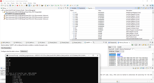

we are using a customized board which is having tms320f28379d. we  need to update the firmware using sci flash kernel. so, I have set the boot select pins GPIO72 & GPIO84 to 0 & 1 respectively. I am using SCIA for flashing (GPOI28-Rx, GPIO29-Tx). we changed the 0x0D00 to 0x815A for emulation test it is downloading the flash kernel to bootRom but main application is not downloading, Can anyone please help me with the correct and concise procedure to begin with. Do I need to make in special changes my code to achieve this? ,

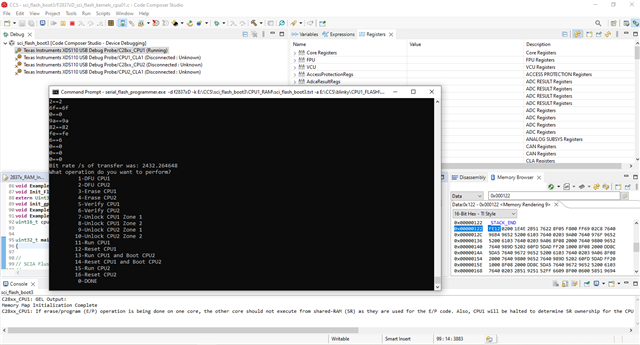

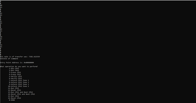

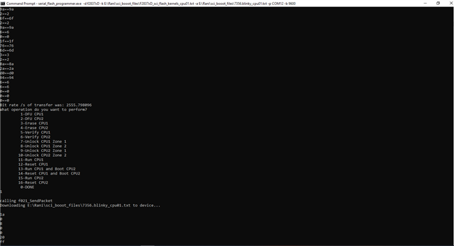

this is my output :
6==6
6==6
0==0
0==0
0==0
Bit rate /s of transfer was: 2392.880371
What operation do you want to perform?
         1-DFU CPU1
         2-DFU CPU2
         3-Erase CPU1
         4-Erase CPU2
         5-Verify CPU1
         6-Verify CPU2
         7-Unlock CPU1 Zone 1
         8-Unlock CPU1 Zone 2
         9-Unlock CPU2 Zone 1
        10-Unlock CPU2 Zone 2
        11-Run CPU1
        12-Reset CPU1
        13-Run CPU1 and Boot CPU2
        14-Reset CPU1 and Boot CPU2
        15-Run CPU2
        16-Reset CPU2
         0-DONE
1
calling f021_SendPacket
Downloading E:\CCS\blinky\CPU1_FLASH\blinky.txt to device...

  • Hi charles Roberson,
    I am not using any control card, I am using the customized PCB (TMS320F28379D). I am new to this controller, could you guide me on how to find out the revision of the control card? I have downloaded the project from C2000Ware_5_04_00_00.
  • Hi Rani,
    The controlCard revision for this device should be located near the microUSB port.
    When the above attempt to program the application is waiting, do we know what is going on the device side in trying to acquire the application?
    Can you load the symbols for the kernel project to see where it is hanging?

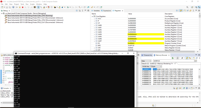

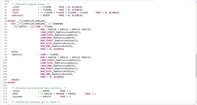

  • Hi Rani,
    For the application being downloaded, is it set to use an alignment of 8 (ALIGN8) in the linker command file?
    Thanks and regards,
    Charles
  • Hi Charles Roberson,2480.files.rar
    The same thing I have did but main application is not downloading. I have attached the kernel file and application file, please once check the file and let me know where I am making mistake.

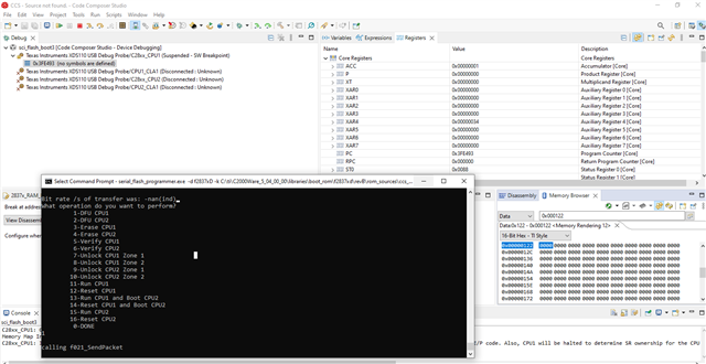

  • Hi Rani,
    With the given kernel file, I am unable to determine the status of "F2837xD_device.h" to confirm if it's using the correct GPIOs.
    When the kernel is running, can we confirm that it is trying to achieve TX/RX communication via GPIO28/29? Can you load the symbols for bootROM to see if the kernel is waiting for response?
    BootROM symbols can be loaded through CCS from this location:
    C2000Ware_6_00_00_00\libraries\boot_rom\f2837xd\revB\rom_sources\ccs_files\cpu01\Release
    Thanks and regards,
    Charles
    The kernel is downloading into RAM means the TX/RX communication via GPIO28/29 is working right?
    After the kernel is downloading the program counter is routing to address 0x0008676 and the main application is not downloading. why it routing to RAMLS0 address location?which address it as to locate?
    And I also run the kernel as you mentioned path, it is not downloading any symbols.
    After the 1- DFU CPU1 selected,
    Please help me to resolve this issue.
  • Hi Rani,
    The bootROM symbols .out file is not meant to be downloaded by the serial_flash_programmer , but by using the Load button option for program load through CCS (after the kernel has loaded and is running on the device).
    Load->Load Symbols
    Charles

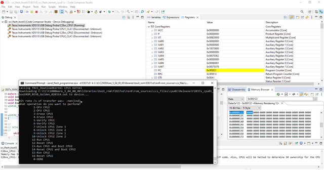

    I have loaded bootROM symbols.out symbols after the kernel is loaded but I did not see any changes.
  • Hi Rani,

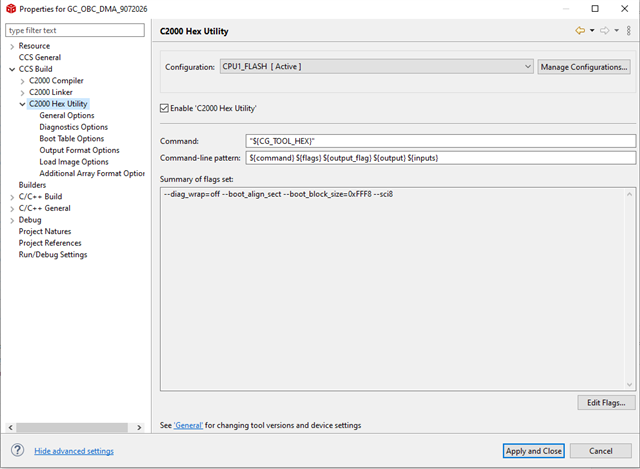

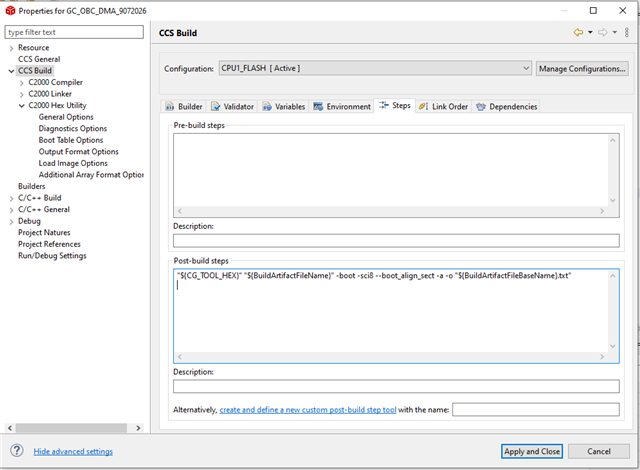

    After loading bootROM symbols and pausing the device in CCS, it should show what the bootROM is attempting as a next execution step. Can you show what the paused bootROM state currently is?
    Also, can you try building the application project with the following post-build step?
    ${CG_TOOL_HEX}" "${BuildArtifactFileName}" -boot -sci8 --boot_align_sect -a -o "${BuildArtifactFileBaseName}.txt"
    The C2000 Hex Utility output format can require breaks to put the data into chunks, with each chunk has a corresponding 16-bit size value in the text file. If a chunk is larger than 0xFFFF then there can be some alignment issues for the destination programming address.
    Thanks and regards,
    Charles
    1. After the kernel has loaded and is running on the device, I have loaded the bootROM symbols. but nothing is happening then i paused the device and it is showing like this
    How I know the bootROM symbols are loading or not?
    Yes, I have included the given post-build step "${CG_TOOL_HEX}" "${BuildArtifactFileName}" -boot -sci8 --boot_align_sect -a -o "${BuildArtifactFileBaseName}.txt"  and build the project.
    2. I have observed the some issue while downloading the main application that is , when the kernel is downloaded, I selected the option 1 - DFU CPU1 while it showing downloading to device, I paused the code and it is stocked at SCIA_GetWordData function. the result I've attached in below image
    Kindly help me out on how to proceed.

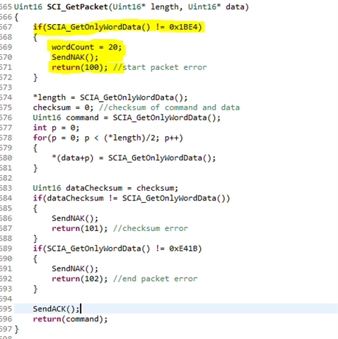

  • Hi Rani,
    If we see that the CCS CPU1 core is in the bootROM section of memory, then we know that the symbols have loaded for it.
    However, it seems like the kernel has loaded to the device and that on the re-initalization it is still waiting for packet identification (as shown in the image above).
    For the SCI Flash kernel, can you try inserting a NOP instruction at the bottom of the while loop in the function SCI_GetFunction in SCI_GetFunction.c?
    Example:
    // Send the packet and if NAK send again.
    while(SCI_SendPacket(command, statusCode.status, 12,
                         (Uint16*)&statusCode.address, statusCode.flashAPIError,
                         (Uint16*)&statusCode.flashAPIFsmStatus))
    // Get next Packet
    __asm(" NOP");
    command = SCI_GetPacket(&length, data); //get next packet
    Thanks and regards,
    Charles
    As you said, I added the NOP instruction in the code, even though it is getting same response.
    Can you conform that if the kernel is downloading in the device means the TX/RX pins GPIO28/29  are in communication right? is there is no any problem with GPIO's?
  • Hi Rani,
    Yes this is correct, if the kernel has downloaded.
    Once the kernel initiates, it will communicate with the expected GPIOs set by the device.h file for SCI_BOOT_ALTERNATE (GPIO28/29).
    For your kernel, are you using INTOSC or XTAL as the device clock? Should it be using the 10MHz XTAL or 20MHz XTAL clock if so? The goal of adding the NOP above was to see if there was a timing issue between the host programmer and the kernel. Since you are using a custom board, I'm not certain of all of the hardware changes that could have impact during the device reset.
    Thanks and regards,
    Charles
    We are using XTAL with 20MHz clock and the PLLSYSCLK output is 200MHz.
    from hardware side if you want me to check any status, You can guide me so, that I can check and inform to you. Kindly help me resolve this issue.
  • Hi Rani,
    Can you describe the status of the SCIHBAUD register? It may need to be cleared to zero prior to calling the SCI bootloader.
    Thanks and regards,
    Charles
    Yes, the SCIHBAUD register is having zeros before and after the kernel is downloaded.
  • Hi Rani,
    Are there any background tasks running on the machine that could be interrupting the SCI communication?
    Also, do you see the same hanging at a lower baudrate (say 4800)?
    Thanks and regards,
    Charles
    There is no any background tasks running on the machine. And Yes, I have tried for 4800,2400,1200 baudrates even though, it is getting same response. I have attached a video for sci communication register status.
    I'll be able to see more to this inquiry by tomorrow's time. Thanks for your patience on this issue.

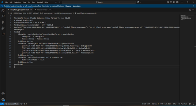

    > For visual studio session for the SCI Flash Programmer.sln Are these steps should I Follow right?
    > But when I opened serial_flash_programmer.sln with visual studio it is open like this.
    Can you guide me how to do this process.
    Visual Studio is what is needed to open the .sln file.
    Thanks and regards,
    Charles
    Yes, I opened the Serilal_flash_programmer.sln file with the Visual Studio but, it is opened like the above image.
  • Even with double-clicking the .sln file? It should open the project in Visual Studio if installed, and not Visual Studio code.
    Thanks and regards,
    Charles

  • Hi Charles,
    What i observed is, after the kernel is downloaded when I send the DFU_CPU1 command from command prompt, in SCI_GetPacket(&length, data)
    function which is
    if(SCIA_GetOnlywordData() != 0x1BE4)
    SendNAK();
    return (100);
    is executing. The  SCIA_GetOnlWordData() is returning 0xE441 instead 0x1BE4. i.e.,
    (wordData = 0x0041
    byteData = 0x00E4
    Checksum += wordData + byteData;
    checksum = 0x0125
     wordData |= (byteData << 8);
    wordData = 0xE441 )
    1. SCI Loopback Example - when i run the this code the loopCount is incrementing and the errorCount is 0.
    2. SCIA_Init function - it is  initializing  SCI_Pinmux_Option2.

    The application is updating properly when the size of the file is small (blink) . But when I update larger file, the below given error is showing.
    I follow the below given thread but still it is not getting. Can you please help me how to resolve this.
     TMS320F28388S: PROGRAM_ERROR when trying to flash with serial programmer
    Can you try using the "--boot_align_sect" flag instead? Please see this thread for more info:  TMS320F28377D: Serial_flash_programmer
    Matt
  • Hi Matt,
    As you said, I have modified but still I am getting same issue.
  • Hi Rani,
    Is it possible that memcpy() is not being called for certain functions? Similar issue seen in this thread about incorrect data buffer length.
    Thanks and regards,
    Charles
    I follow the thread but even though the issue is not resolved. I have attached the files, please once check and let me know where I am making mistake.
