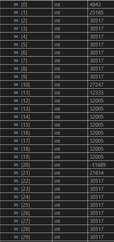

    I've done the test on F28P65 launchpad with nothing connected to the SD_data input. In the fifo ISR, I reconfigure the OSR with SDFM_setFilterOverSamplingRatio every 10 samples. This is what I get into memory after test:
    After OSR change I get transitions values like after a reset.
    Could you confirm that I use the right way to do, and so that dynamic OSR changes is not supported

  • Hi Geoffrey, Gildas,
    It sounds like your results are working as expected with the on-the-fly OSR updates, there is nothing explicitely stating that this isn't possible, I would recommend you evaluate the possible OSR settings and ensure that there are no other associated bitfields that may also need to be adjusted to accomodate the given OSR values.
    I would also like to identify if their is a problem with resetting and reconfiguring the entire SDFM module for every OSR transition (so the IP is a known good/ready state)?

  • Hi Zackary,
    My aim is to evaluate a continuous sigma delta filtering and use the on-the fly OSR update to compensate 20 MHz SD clock drift from an external base clock, so I need to use all the filter's output values and having 2 unusable values after changing OSR is not acceptable
    I've done the same test on AM243x PRU SDFM and as you can see in AM2434: SDFM peripheral - questions - Arm-based microcontrollers forum - Arm-based microcontrollers - TI E2E support forums the behavior is more like what I expect (even if I stall have driver issue), changing OSR do not reset filter.

  • Hi Zackary,
    The result I have obtained on AM243x is by manually changing OSR value inside register during a breakpoint. I've done the same test with the workaround provided by Achala wich no more require breakpoint and allow register update by ISR and now, I get the same behaviour with 2 unusable values. I suppose that breakpoint on AM243 do not stop SDFM.
    So there is no more difference between F28P65 and AM243 on SDFM in case of OSR update.
