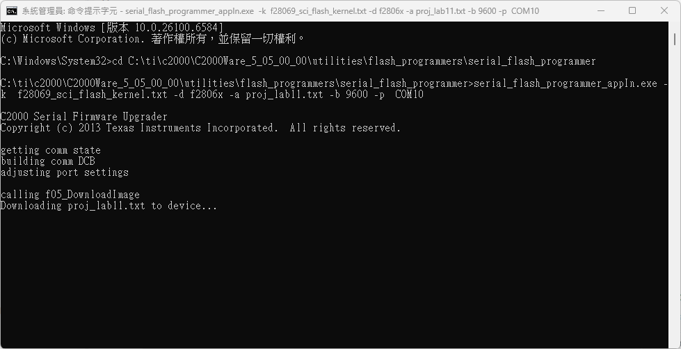

I used the serial_flash_programmer to flash the converted APP.txt file, but an error message occurred.
...ers\serial_flash_programmer\serial_programmer_appln.exe
File:minkernel\ucrt\src\appcrt\stdio\fopen.cpp
Line: 30
Expression: file_name != nullptr
I have already flashed the converted f28069_sci_flash_kernel.hex file using UniFlash 9.2.0 according to the file (the bootloader is located in Sector H, 0x3D8000 to 0x3DBFFF). The bootloader program uses SCIA to flash the APP.
The APP is allocated in Sectors C+D+E+F+G, separate from the bootloader.
Here, since 28069M is used, is the <device> input f2806x correct? The instructions don't mention this.
Since the baud rate is automatically detected, 9600 should be sufficient, right? COM10 has also been confirmed.

    Yes, f2806x should be the correct argument given for this device. Can you also give the name of the kernel file that you are using as an argument? The error may be related to the -k argument not being present.

    What is the -k argument?

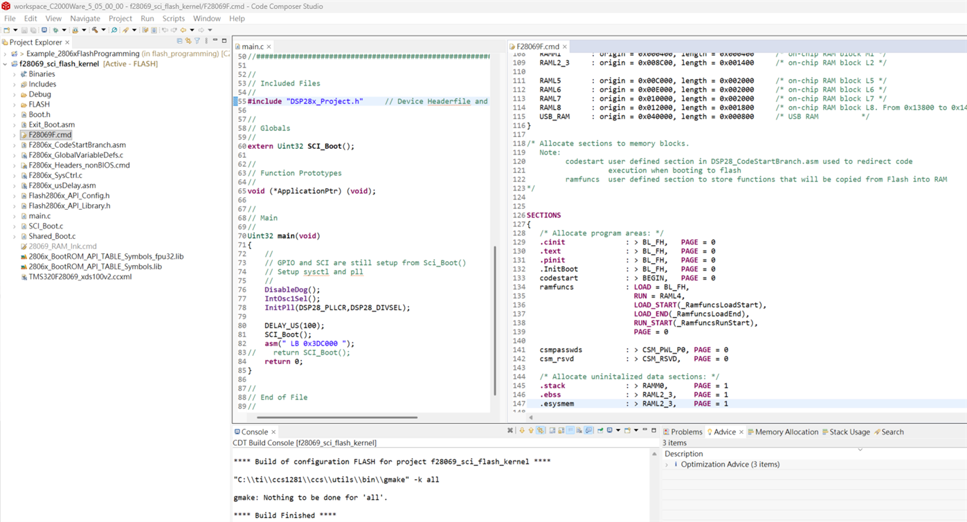

    Because we want to keep it in Get mode (e.g., Flash), we use F28069F.cmd as the configuration file. The bootloader space is set to 0x3D8010, length = 0x003990, and the app's starting location is set to 0x3DC000.  That's right, right?

  • Hi Chi-Hsiang,
    The -k argument given is for the kernel file that is used to load the application. Although you are first loading the kernel to the device using CCS, the appln version of the serial flash host programmer executable would still require the -k argument as input.
    For example:
    serial_flash_programmer_appIn.exe -k f28069_sci_flash_kernel.txt -d f2806x -a proj_lab11.txt -b 9600 -p COM10
    The default linker command file should be fine.
    Thanks and regards,
    Charles
  • Hi Charles
    Thank for your reply,
    There seems to be no error in the window, but it does not seem to be burned in. It is stuck on the word "downloading"
    Chi-Hsiang Chen

  • Hi Charles
    What can I do after loading the bootROM?
    It's definitely burned in here. I've confirmed that the execution jumps to asm("LB 0x3DC000")
    I tried the example a few more times and found a problem.
    My goal is to be able to flash the kernel without using a boot file. However, the example in f28069_sci_flash_kernel seems to differ from the one provided in the documentation (attached).
    C2000 bootloader.pdf
    The document says that you can burn the flash first, then run the command from the Windows command prompt without the -k parameter (it also doesn't mention switching to SCI Boot mode).
    Are there any 28069-related examples available for me?
    The attached example is located in \C2000Ware_x_xx_xx_xx\driverlib\f28004x\examples\flash\ flash_ex2_sci_flash_kernel
    Chi-Hsiang Chen
  • Hi Chi-Hsiang,
    For this device, there does not currently exist an example, known as the Live Firmware Update, that allows the Flash Kernel to reside in Flash memory (so you do not have to burn the kernel every time).
    Thanks and regards,
