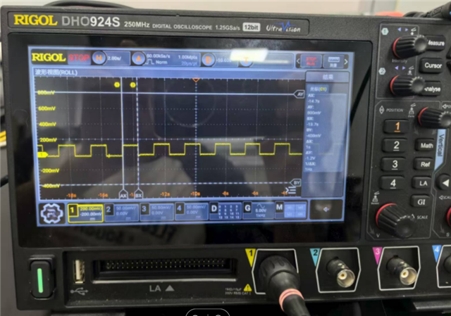

Customer feedback an issue with F28069 LP, they use the SDK demo Example_2806xGPIOToggle, the modifications are below, the jumper are MUX_SEL(0) CH_SEL(1):
Step 1: Set GPIO15:
GpioCtrlRegs.GPAPUD.bit.GPIO15 = 1;
GpioCtrlRegs.GPAMUX1.bit.GPIO15 = 0;
GpioCtrlRegs.GPADIR.bit.GPIO15 = 1;
GpioCtrlRegs.GPACLEAR.bit.GPIO15 = 1;
Step 2: Add GPIO toggle in Gpio_example3:
for(;;)
GpioDataRegs.GPATOGGLE.all = 0xCFFF FFFF;
GpioDataRegs.GPBTOGGLE.all = 0x0000 000F;
delay_loop();
GpioDataRegs.GPATOGGLE.bit.GPIO15 = 1;
but you can see the scope, there is only ~200mV when the gpio is pulled up in the code.
Could you please try this on the LP to see whether you can reproduce the issue and how to solve?
