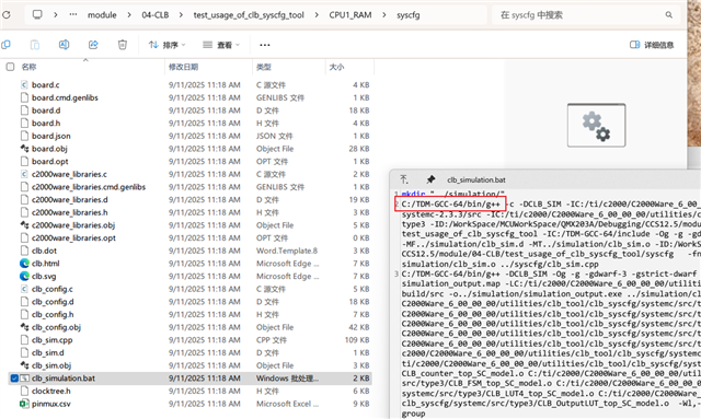

LAUNCHXL-F280039C: How to change the reference GCC compiler path for 'clb_simulation'
Part Number: LAUNCHXL-F280039C

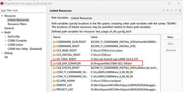

In my CCS project, I already changed the value of 'Path Variables' named 'CLB_SIM_COMPILER' to another different path: 'D:\ProgramFiles\TDM-GCC-64\bin', which is the actual install directory of my GCC, but why my building output 'clb_simulation.bat' file still reference to 'C:/TDM-GCC-64/bin/g++'? how to solve this problem
  • Hi Hengchen,
    I don't think the project properties is meant to automatically update the .bat file, you will need to manually edit the .bat file as a text file to use the correct GCC path.
    Thank you,
    Luke
  • Hi Luke,
    Thanks, I already solved this by modifying the template file "<C2000Ware>\utilities\clb_tool\clb_syscfg\source\.meta\templates\script\clb_simulation.bat.xdt" to use the correct GCC path, now it works just fineGrin
