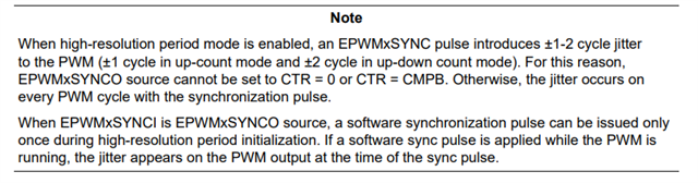

I am trying to create 2 PWMs with HR enabled (period, duty cycle and deadband), and synchronize them so I can add a phase between them.
The problem is that when I try to set a value to TBPRDHR while synchronized, the PWMs have jitter. If i leave TBPRDHR set to 0, or disable the syncronization between the two, the jitter dissapears.
Are there some limitations in this sense, or am I missing something else?

CpuSysRegs.PCLKCR0.bit.TBCLKSYNC = 1;
EPWM_enableSyncOutPulseSource((uint32_t)masterPWM->pstEPwmAddr, EPWM_SYNC_OUT_PULSE_ON_CNTR_ZERO);
EPWM_selectPeriodLoadEvent((uint32_t)slavePWM->pstEPwmAddr, EPWM_SHADOW_LOAD_MODE_COUNTER_SYNC);
slavePWM->pstEPwmAddr->TBCTL.bit.SWFSYNC = 1;
slavePWM->pstEPwmAddr->TBCTL.bit.PHSEN = TB_ENABLE;
