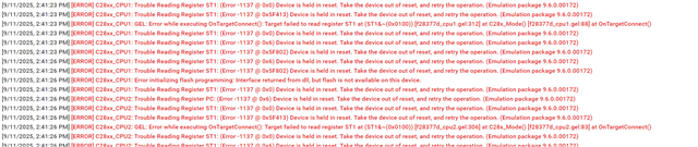

We have several identical circuit card assemblies with 28379D microcontroller installed. We are able to program most of them with UNIFLASH except one board. When we try to load CPU1 program (this is a dual core micro-controller), it gives us "data verification error". The detailed error message shows below. It seems the software also try to access CPU2 at the same time.

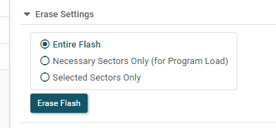

We also tried the "Erase Flash" function under the Settings & Utilities, and the system also gives us the error.
