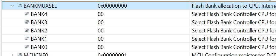

I defined flash bank 1 and 2 as FLASH_BANK_APP in .cmd file and used them. And in my code, I assigned all FLASH BANKs to CPU1.

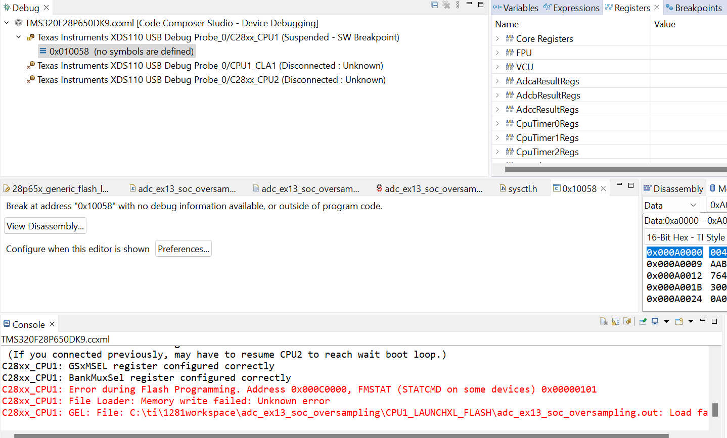

When the code size in my FLASH is less than 0x20000, my code is all stored in FLASH BANK1 and can be programmed normally. However, once the code size is greater than 0x20000, that is, the code needs to be stored in FLASH BANK1 and 2, my programming will fail and the error message is as follows:

C28xx_CPU1: GSxMSEL register configured correctly
C28xx_CPU1: BankMuxSel register configured correctly
C28xx_CPU1: Error during Flash Programming. Address 0x000C0000, FMSTAT (STATCMD on some devices) 0x00000101

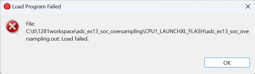

C28xx_CPU1: File Loader: Memory write failed: Unknown error
C28xx_CPU1: GEL: File: C:\ti\1281workspace\adc_ex13_soc_oversampling\CPU1_LAUNCHXL_FLASH\adc_ex13_soc_oversampling.out: Load failed.
