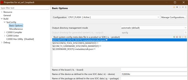

    Here are the configurations in the Project Properties post following the steps in the Security Tool document:

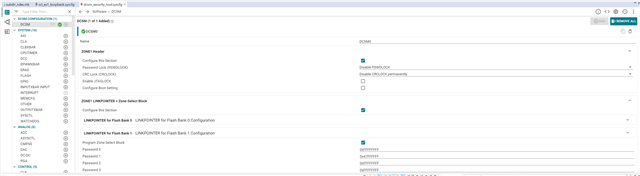

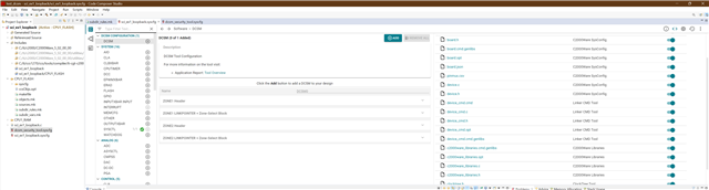

    I see that when I try to see the generated dcsm.asm and dcsm.cmd (they are not generated yet, just wanted to check it out), I get the same error as before, that dcsm.asm and dcsm.cmd are declared more than once:
    I am just not sure how is this possible. There are just two syscfgs as shown below, and in the SCI syscfg, the DCSM section is not at all configured:
    So, I am unaware as to how it is declared more than once.

  • Hi Sumukh
    You cannot have two syscfg files in the same project.  You will have to add configurations for the DCSM section in the SCI syscfg file.
    Best Regards
    Siddharth
  • Yeh, it appears so.
    The project is building now if I just configure DCSM within the existing syscfg file itself.
    Perhaps it would be better if this is mentioned somewhere, or better yet, in the C2000 DCSM Security Tool doc itself.
    I think that doc is old and by default, SysCfg is not present in the example projects of older CCS versions, so that is the reason the 2nd point in the section mentions a dialog box that enables SysCfg.
    Alright, thank you.
  • However, I have not added the DCSM variable in the Linked resources or the syscfg options in the Project Properties, as mentioned in the doc.
    So, if the Build for the project goes through, does it mean it included the .asm and .cmd in the .out file creation of the project? Or it did not?
  • The issue reappears if I include the DCSMTOOL_SYSCFG_ROOT variable paths in the Project properties, even if I use a single syscfg file in which DCSM is configured:
    So, what is the exact procedure to be followed to use DCSM when it is configured within the existing syscfg file of the example project?
    Should the DCSMTOOL_SYSCFG_ROOT path be included to build the project so that the .out file is created with the DCSM configurations?
    Or,
    Should the DCSMTOOL_SYSCFG_ROOT path not be included to build the project?
  • Hi Sumukh,
    If you are utilizing other features of sysconfig besides DCSM you should not need separate include paths for DCSM such as DCSMTOOL_SYSCFG_ROOT, you simply need to configure DCSM in the same .syscfg file as the rest of your project.
    Thank you,
    Luke
