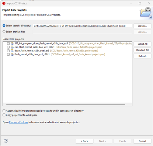

    Can you explain more what you mean by you "can't import" the example - does CCS throw errors if you do File >> Import Project(s) and navigate to can_flash_kernel_c28x_dual_c28x1? Can you comment on which version of CCS and C2000ware you are using as well?

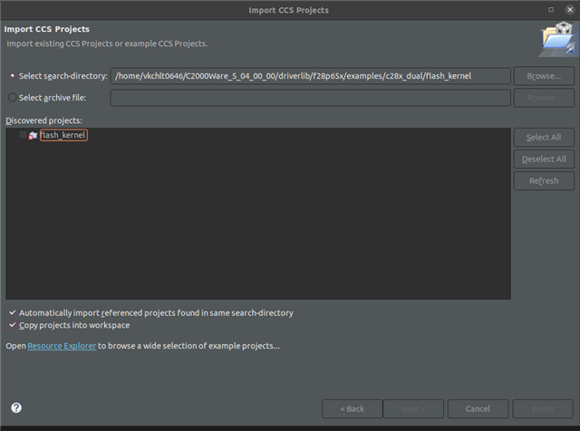

  • Hi
    It is possible to import other projects into the workspace and work on them. However, when I tried to import the flash kernel for F28P65x, it did not import successfully.
    I have tried this in CCS v12.8.0 and CCS v20, but the issue persists.

    This is what I see when I try to import into CCS 12.8.1 for that folder:
    Are you sure your flash_kernel/ folder in C2000ware didn't get corrupted? Also note that CCS can only import one project of a specific name, if you already have a project with a matching name existing in your workspace, you will need to rename it.
    I will loop in the bootloader expert to assist with your other questions.
