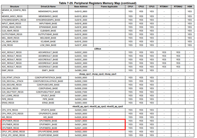

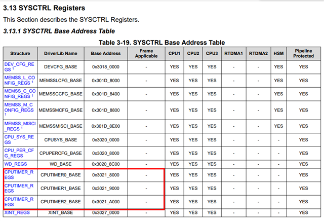

  • One more thing,
    Now I could update these address as u can see for CPU1 on left and CPU3 on right, But the CpuTimer1Regs for both the CPU has same address, is this normal?
    I read both the CPUs have 3 timers and thus it should have different address, right? Maybe I am doing something here wrong, thus asking. If I do also have to initialize such address for other timers.
    Deep
    The CPU Timers are not frame applicable which is why you see different base addresses in the map file as mentioned here in the TRM and datasheet.
