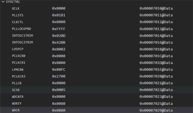

I am trying to implement a watchdog test on the TMS320F28035. The goal is to enable the watchdog, provide a delay greater than the configured timeout period, and check if the watchdog resets the system. I also want to confirm through a register check that the reset was caused by the watchdog and not by power-on reset.
For testing, I added a while loop. The system resets (my LED toggles between main() and the watchdog test loop, so I can see the resets happening). However, the WDFLAG bit in the WDCR register never gets set. The condition if ((SysCtrlRegs.WDCR & 0x0080) != 0)  never becomes true, so the watchdog test always fails.
When I check during debug, the WDCR value is always 0x0046. Even if I explicitly write SysCtrlRegs.WDCR = 0x002E;, reading it back still shows 0x0046.

static Uint8 bit_pbitWDTTest(void)
Uint8 WDTTestPassed = 0;
// Check if last reset was due to WDT
if ((SysCtrlRegs.WDCR & 0x0080) != 0) // WDFLAG
WDTTestPassed = 1;
else
while (1)
GpioDataRegs.GPBSET.bit.GPIO33 = 1; // LED
return WDTTestPassed;
What is the problem here?
