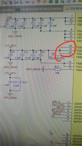

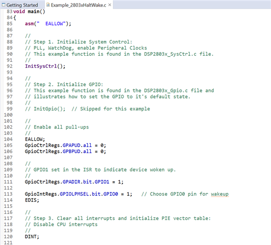

We are using F28035 and need to configure into HALT mode. Key reference code is C2000Ware_5_05_00_00\device_support\f2803x\examples\c28\lpm_haltwake. However when we execute the code into F28035, we find the quiescent current of VDDIO pin is about 30mA, that's much higher than datasheet description, and we already disconnect hardware pin and make them floating, and the measure area is at VDDIO pin directly, see below red circle area. Could you help to share the correct code setting for F28035 enter HALT mode? thanks.

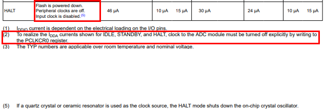

  • Hi Wiky,

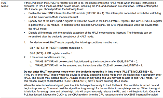

    Just to verify, how you turned off ALL the peripheral clocks on the device as recommended in the datasheet by clearing the PCLKCRx Peripheral Clock Control Registers?
    It also contains the below recommendations to further reduce power consumption when operating in any mode.
    Have you followed all the recommended steps defined in the associated TRM chapter as well?
    Zackary Fleenor
  • Hi Zack,

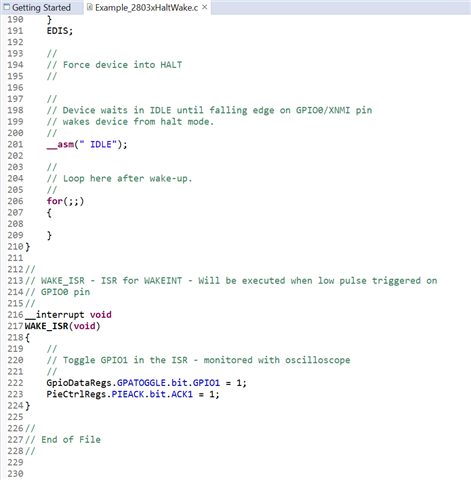

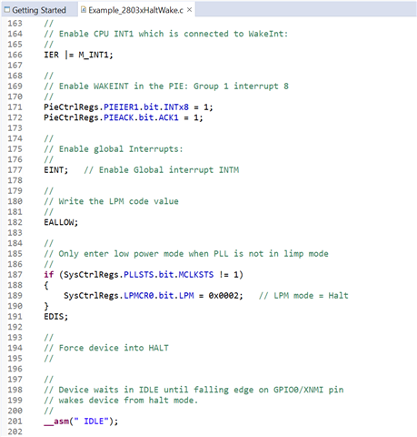

    We already load the example code into F28035 directly, it comes from C2000Ware_5_05_00_00\device_support\f2803x\examples\c28\lpm_haltwake without any changing. See below snapshot. From test result the VDDA quiescent can meet datasheet requirement, but VDDIO power is much higher(30mA). Could you help to confirm this demo code is all of setting about HALT mode?
  • Hey Wiky,
    I don't see anything wrong with the code you shared, as you mentioned it matches the source example exactly.

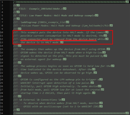

    One thing to check, are you keeping the JTAG connection active during the testing?
    An active JTAG connection will result in additional VDDIO power consumption.
    Zackary Fleenor
  • Hi Zack,
    No, we disconnect the JTAG when power consumption measurement, the test result looks the same.

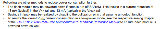

  • Wiky,
    I would go back to the post Zack made about steps to ensure lowest power.  I looked through the example code, and I don't see the flash getting powered down; we need to make sure that halt mode prep code is running out of RAM, and then activate halt.
    Any access to flash memory will wake it up, so we need to be in RAM when we go into HALT.
    Matthew
  • Hi Matt,
    We power down the flash and copy the code to RAM, the test result looks good, it can match datasheet parameter now. Thanks for your guidance.
