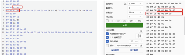

My ported logs based on manual and demo reference are as follows:
00 00 00 00 00 00 00 00 00
00 00 00 02 02 00 00 05 05 05 05 01 01 00 00 00 00 00 40 05 05 06 06 01 01 00 00 0A D7 A3 3B 05 05 07 07 01 01 00 00 A4 70 8D 3F 07 07 00 00 00 00 00 00 07
07 00 00 00 00 40 40 07
07 01 01 0A 0A D7 D7 07
07 01 01 A3 A3 3B 3B
00 00 00 00 02 02 00 00 04
04 00 00 01 01 00 00 64 00
04 04 00 00 01 01 00 00 64 00 04 04 00 00 01 01 00 00 64 00 04 04 00 00 01 01 00 00 64 00 04 04 00 00 01 01 00 00 64 00 04 04 01 01 01 01 00 00 00 00 07 07 02 02 4E 4E 7A 7A 07
07 02 02 8D 8D 3F 3F
Through comparison, we can see that there are duplicate data sent. The demo on the left side is 049, and the demo on the right side is 28379. When the data is sent after transplanting, compared with normal, there is a situation where one byte is sent twice. Originally, 02 00 05 05 01 00 Sent 02 02 00 00 05 05 05 05 01 00 00 00 05 05 01 01 00 00
At the same time, strangely, in this case, the upper function can show a successful connection.
Why is this situation?
