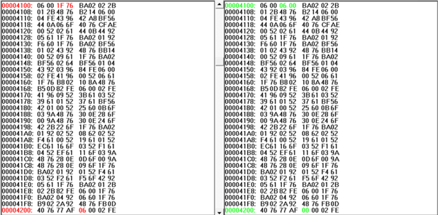

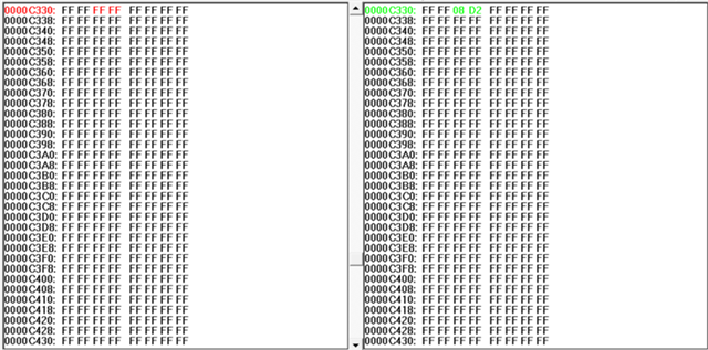

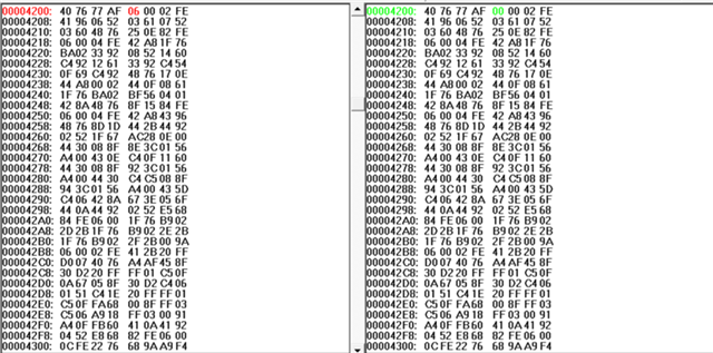

Recently, they receive factory site feedbacks there are 8 units (total 3000 units) programmed with the same code. Dumping these 8 units memory content, there are few data different from the good programmed unit (the wrong data address seems to be random in these 8 units), then these 8 units MCU couldn't work properly because of the wrong data.
They use Command Line Interface to do the load program and verify, the failed 8 units didn't show any ERROR message after programming in the log. But dumping the failed unit memory, we do see there is some difference compared with good unit.
Left one is Good Sample memory vs right one is Failed sample memory, dumping from Flash Bank0 0x80000-0x8FFFF

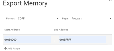

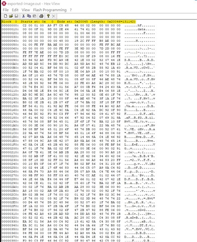

(3). Customer export the flash Bank0 0x80000-0x8FFFF from Uniflash, the length should be FFFF. However, from hex view, it is calculated with 0x20045. Any misconfiguration ?

    >Would the expert consider those unexpected data on failed unit is because of Uniflash programming issue? Have the expert ever seen such issue? Showing load successfully, but with different data memory.
    If many other units are unaffected, it is doubtful to be due to UniFlash programming itself. Are these units able to be erased after failure? If not, this might be due to Uncorrectable ECC Error.
    >Customer export the flash Bank0 0x80000-0x8FFFF from Uniflash, the length should be FFFF. However, from hex view, it is calculated with 0x20045. Any misconfiguration?
    This hex length seems incorrect, yet this is a generated .out file length. Is this the same for a generated TI-TXT file?
    Able to be erased after failure. Re-flashing the unit, then the code works properly as good sample.

    Have checked the bits of RESC and NMISHDFLG register with JTAG, no abnormal events happening to have the bits raised, eliminate uncorrectable ECC Error possibility here.
