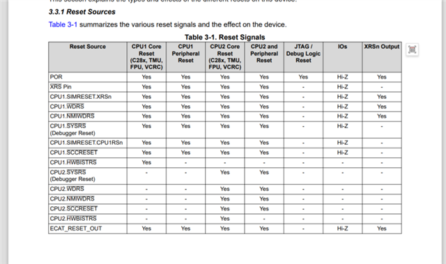

Hello, expert. How can CPU2 be reset to restart from BOOT?
How should ECAT_RESET_OUT be implemented if CPU2 is used?

Hi Nie,
Can you provide more details on what you are implementing?
You can find multicore examples in the SDK for CPU1, CPU2 applications.
Please refer to similar E2E s - (+) TMS320F28P650DK: CPU2 watchdog reset - C2000 microcontrollers forum - C2000︎ microcontrollers - TI E2E support forums
