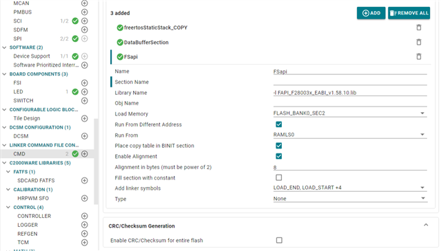

I check the example code,  the CMD file is different as "sysconfig" auto-generated cmd file. like below.

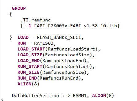

this is example CMD about library.

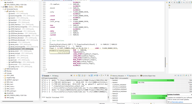

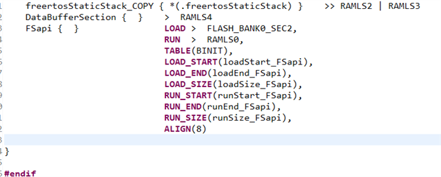

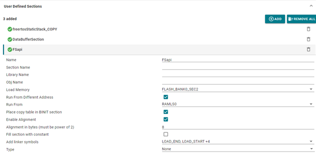

this is GUI setting and generated file. there missing  "group" command.
and I dont find read out code in example. could you help on?
thanks
