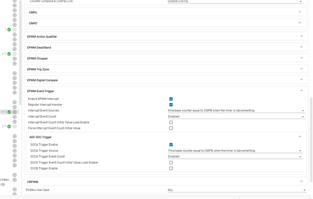

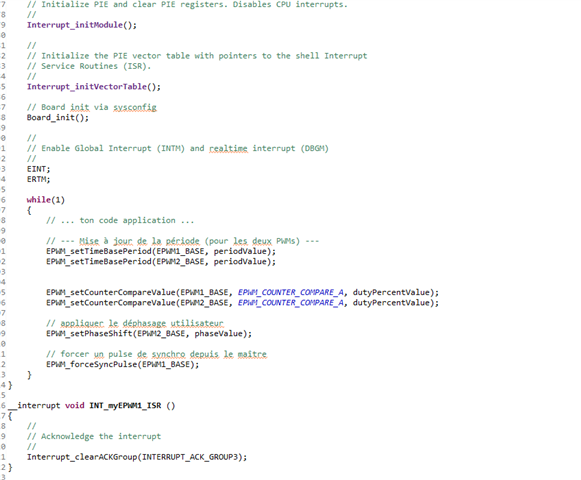

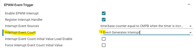

I am not very familiar with sysconfig, but I tried using it for my shift phase. I was able to configure the PWM for channels A and B; however, I am facing an issue with the PWM interrupt.
When I look at the epwm register, it looks like the interrupt is not coming even if i enable it and configure cmpB for trigger.
I will attach the project in a zip file so that you can quickly import and open it.
