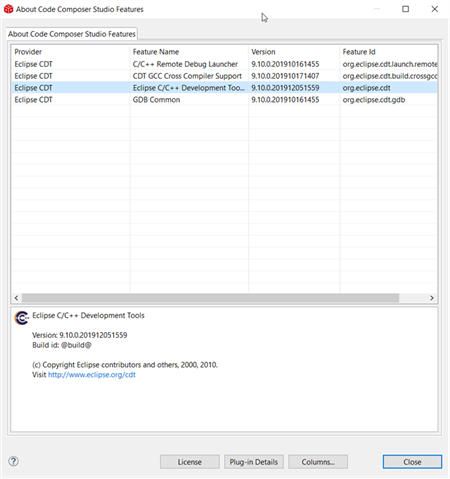

Our configuration:
CCS Version: 10.3.0.00007
