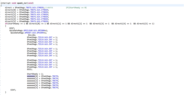

Code changes:  The CC value of the original PWM was updated with the shadow register at CTR = 0, and the original interrupt was only generated at CTR = 0. Later the CC value is updated through the shadow register at CTR = 0 and CTR = PRD, and interrupts are generated at CTR = 0 and CTR = 1.
Problem Generation: The OST is forced to trigger at initialization, cleared after the conditions are met in the interrupt to generate a PWM wave, in the original configuration, the OST is cleared in the interrupt. When only one interrupt is triggered, PWM wave timing is not an issue. However, after modifying the EPWM configuration, there are times when PWM wave timing does not match the expectation, by querying the data, there is a description When CTRL_DIR = 0 clears the OST, a reset signal is generated. The CTR that decrements the 2500 count to 0 immediately and instantaneously decreases to 0, so the resulting PWM wave timing is not as expected. But when I restricted CTRL_DIR = 1, clearing the OST, there is still a probability that the cleanup will occur at CTR = 0, and it will focus on the GPIO ports of the two PWM waves EPWM5 and EPWM6. It was originally suspected that there was an error in the execution time, which caused the program to be executed at CTRL_DIR = 1, but the hardware only responded at CTRL_DIR = 0, so there was a limitation in the ISR service function. However, unexpected PWM timing is still occasionally observed. Since the application scenario is very strict with timing requirements and must be in, please ask what methods are available to make OST safe to clear.
Steps to clear OST in ISR:
Initial configuration is software tripping:
The CTR reading from EPWM1 to EPWM6 at the time of the error
Correct first PWM wave
Wrong first PWM wave, software shut off after hardware detected

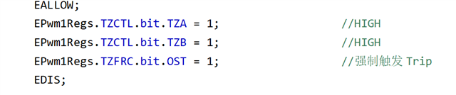

   // Trip set
    EALLOW;
    EPwm1Regs.TZCTL.bit.TZA = 1;                    //HIGH
    EPwm1Regs.TZCTL.bit.TZB = 1;                    //HIGH
    EPwm1Regs.TZFRC.bit.OST = 1;                    //强制触发Trip
    EDIS;

            // Trip set
             EALLOW;
             EPwm5Regs.TZCTL.bit.TZA = 1;                    //High
             EPwm5Regs.TZCTL.bit.TZB = 1;                    //High
             EPwm5Regs.TZFRC.bit.OST = 1;                    //强制触发Trip
             EDIS;

               // Trip set
                EALLOW;
                EPwm6Regs.TZCTL.bit.TZA = 1;                    //High
                EPwm6Regs.TZCTL.bit.TZB = 1;                    //High
                EPwm6Regs.TZFRC.bit.OST = 1;                    //强制触发Trip
                EDIS;
