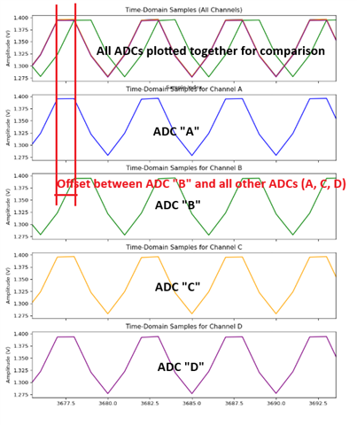

Problem:
I collected samples using the configuration above and I can see that 1 ADC has a random sample delay compared to the other 3 ADCs. In other words, 3 ADCs are perfectly aligned and 1 ADC is offset by +1, -1 or 0 samples. When I use debug mode, ADC-A (the first ADC to be configured) is almost always the ADC that is offset compared to the other 3 ADCs.
When I flash the program to flash and run from flash, often ADC B (the 2nd ADC to be configured) will be offset compared to the other ADCs.
The delay compared to other channels appears to be random but always (+1, 0, -1) samples.
