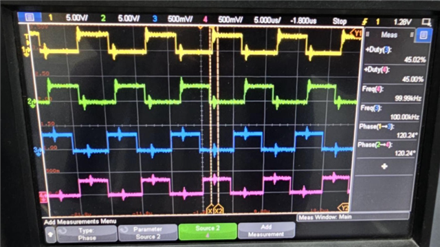

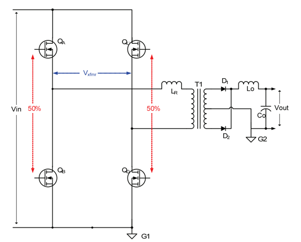

I have generated the phase-shifted PWMs of 100kHz for Phase-shifted Full bridge application.

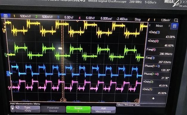

during testing in open loop, at 100V hv input to PSFB, the phase-shifted PWM pins' frequency change to 200kHz.
This was not observed at lower voltages of 60V and 80V.
the PSFB is rated for 320V (nominal), 2.5KW.
Here are the images for reference:
PWM QA is Yellow
PWM QB is Green
PWM QC is Blue
PWM QD is Pink
PWMs at 60V:
PWM at 100V:

  • Hello Stevan,
    We are generating 4 PWMs; PWM_1A, PWM_1B, PWM_2A, PWM_2B.
    We kept same configuration for both ePWM modules, except that the PWM_2A and PWM_2B are phase-shifted with respect to PWM_1A and PWM_1B.
    And we are facing this issue with only the PWM_2A and PWM_2B.
    In the ePWM modules, we are keeping frequency constant and giving duty ratio and phase-shift via CAN.
    Since we are not selecting any dead-time, there shouldn't be any change.
