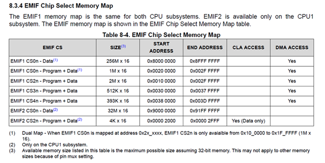

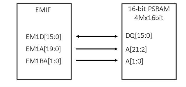

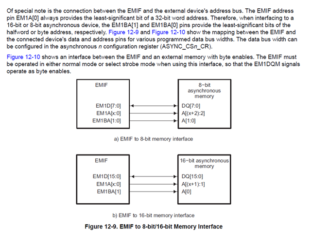

Hello, I want to use EMIF to interface with a 4Mx16 PSRAM. I’d like to confirm whether this configuration is feasible
