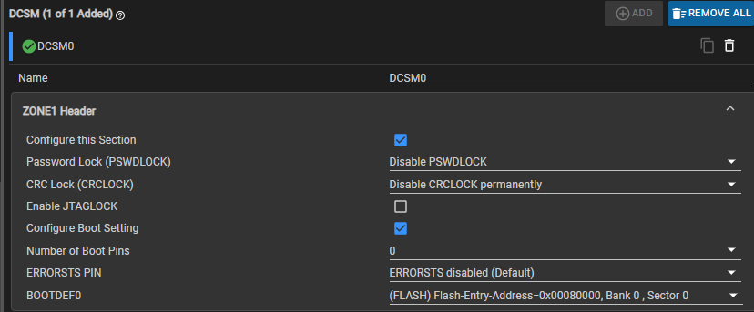

Moreover, when activating the DCSM module (no longer emulation only) to boot from Flash Bank 0, Sector 0:
This generates the following assembly code:
     .sect "dcsm_otp_z1_pswdlock"
      .retain
      .long 0xFB7FFFFF
      .long 0x7FFFFFFF     ;Reserved
     .sect "dcsm_otp_z1_crclock"
      .retain
      .long 0x4BFFFFFF
      .long 0x3FFFFFFF     ;Reserved
     .sect "dcsm_otp_z1_jtaglock"
      .retain
      .long 0x9FFFFFFF
      .long 0x0FFFFFFF     ;Reserved
     .sect "dcsm_otp_z1_gpreg"
      .retain
      .long 0x5AFFFFFF     ;Z1OTP_BOOTPIN_CONFIG
      .long 0x5AFFFFfF     ;Z1OTP_GPREG2
     .sect "dcsm_otp_z1_bootctrl"
      .retain
      .long 0xFFFFFF03     ;Z1OTP_BOOTDEF_LOW
      .long 0xFFFFFFFF     ;Z1OTP_BOOTDEF_HIGH
What concerns must one have regarding RAM sectors? Especially regarding the HAL_clearDataRAM instructions, since before my suggested fix, during the emulation, the boards would freeze. I want to prevent sending wrong OTP code.
